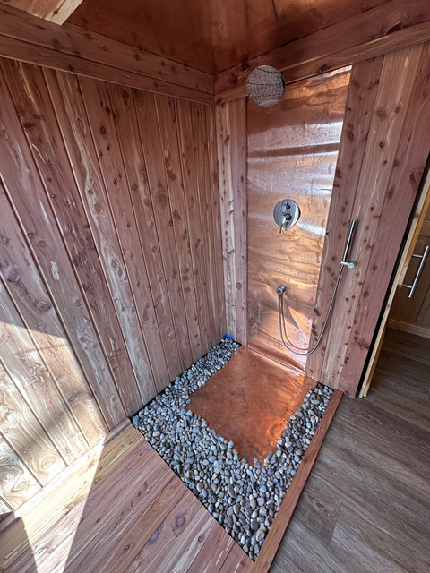

| lol i suppose it's possible that someone could look into the window, but they would have to be on top of a mountain in the national forest at least 4 miles away. 65 acres of trees and a 600' elevation difference to the nearest house means no chance of locals peeping. pretty much 45% slope down from the window so all they would see is the ceiling anyways |
That shower does look cool. I imagine you're gonna remove all the gravel and wash it outside when you need to clean it? My wife has long hair and what you have going on would be a nightmare to the point I may just toss the old stone and replace with new each time it needs cleaning. |

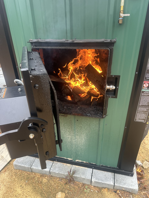

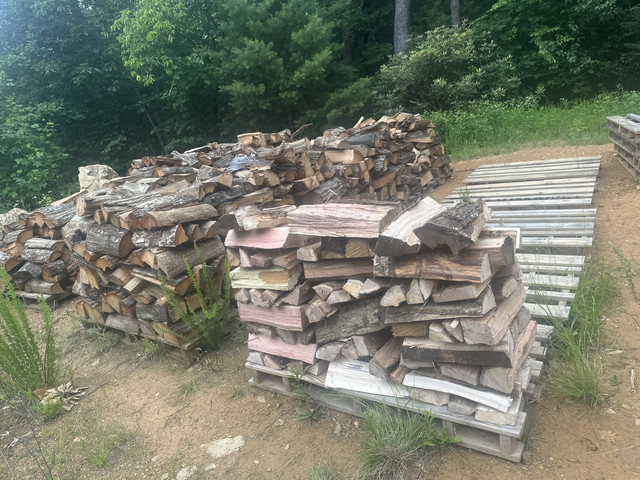

Bit of an update. Even though I’m not running the boiler in the spring and summer I’m still checking the water level. I’ve had a very slow leak which is super annoying because adding water messes with the ratio of anti corrosion chemical additive. Since I couldn’t find the leak I replaced all the stupid shark bite with legit permanent connections and the leak magically went away. Those things are a stupid amount of money for unreliable connections. Also by end of week I should have 5 cords of wood stacked and drying. Stacked 3 since Wednesday. All other systems running remarkably well. Just about everything is debugged and in a maintenance mode which turns out to be a fair amount. Aside from 3 chimneys, the diesel air heater requires cleaning, as does the boiler and tiny wood stove. The incinerator toilet needs occasional maintenance, etc. |
| The wooden grate of teak was plan A. I was planning to do the whole floor in it. But I thought it would be annoying to stand on so I did this. Now that you mention it though it would be pretty easy to make a horseshoe shaped grate to just replace the rock if it becomes problematic. |

Originally Posted By taliv: First deep freeze and 4+ inches of snow passed uneventfully but well over a month before winter. Could be a long one. Trying to track wood usage in the boiler. I’m currently estimating 7.4 cubic feet of wood per freezing day. That’s roughly 18 days per cord. With 5 cords stacked, I have enough for about 90 freezing days. If we froze all winter I’d definitely need more. But Dec and March are above freezing and use a lot less wood per day. So still hoping 5 is enough to get me to spring even though I plan to replace a cord as soon as I use it. Also some gratuitous fall leave pics https://i.ibb.co/SXWXk63q/IMG-5437.jpg https://i.ibb.co/QFZXHKjd/IMG-5436.jpg https://i.ibb.co/nNqjYcBR/IMG-5443.jpg Great colors, yeah I'd want some extra cords of wood |

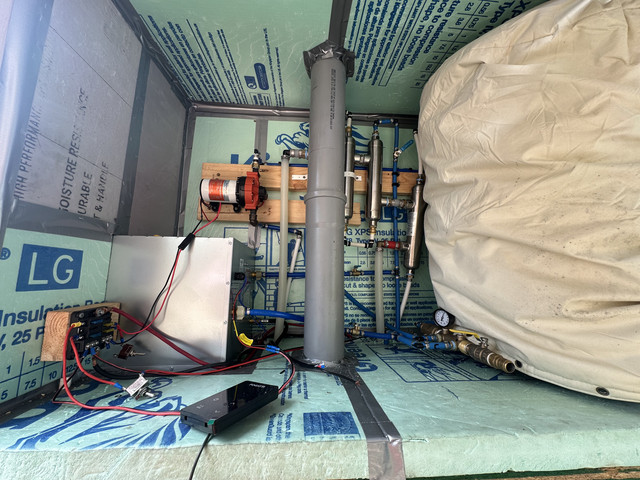

Originally Posted By taliv: Winter update. Short story is we got about 12+ inches of snow and I couldn’t get up and down the mountain to restock my wood. (I keep about 5 days of wood up top due to limited space and the main wood storage is about 500’ lower elevation.) So when the wood ran out, the boiler got cold, everything froze. Low Temps were near zero for several days. (2-4 days below zero). And once again everything froze. Been slowly working on fixing all the plumbing. Finally have running water again indoors after replacing cracked heat exchanger, cracked pex, all 3 pumps, propane instant heater etc. This time, I ripped everything out and thoroughly insulated my plumbing box. Rerouted pex and relocated pumps. Relocated the electric fuse box etc. It’s smaller since there’s 2” foam sealed on top bottom all sides and the door. But relocating everything actually made working on it a little easier. https://i.ibb.co/35k20ZXB/IMG-5771.jpg Still working on insulating outside the box by building plywood boxes around the pex lines and insulating inside them. This summer I’d like to build a compressed air system to blow water out of the pipes so I can winterize it if I’m not planning to run the boiler. Can you drain the pipes by opening a low-point valve and pour RV anti-freeze down the drains? |

Originally Posted By tree-hugger: Can you drain the pipes by opening a low-point valve and pour RV anti-freeze down the drains? My system (same stove) is just water, but people around here frequently use antifreeze in their lines for this reason. If you are at frequent risk of freezing up, I would definitely recommend going that route rather than trying to drain and refill (especially off grid with limited water resources) |

Originally Posted By tree-hugger: Can you drain the pipes by opening a low-point valve and pour RV anti-freeze down the drains? So there’s two circuits. The heated water. And the heating water. The heating boiler circuit is closed and like loon said, can be solved with about 150 gal of glycol / antifreeze. However I did add a drain at the low point. Unfortunately, the heat exchangers are complex meshes of copper and steel pipes to maximize heat transfer. It doesn’t lend itself to draining. I’m doubtful I can even blow it out with compressed air since it’s a 1” pipe. The heated water is easily drained. |
