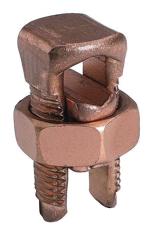

Incidentally, trimming the dipole will be much easier if you use a pair of split bolt connectors. It will save you from wrapping and unwrapping the wire at the end insulators as you bring the antenna into resonance. Your local electrical supply house should have them. Get the smallest size they have.
