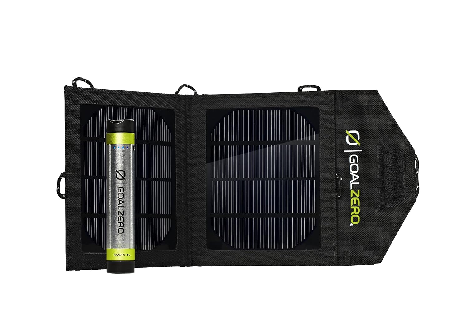

Goal Zero Switch 8 Kit (Nomad 3.5 Panels): $82.54

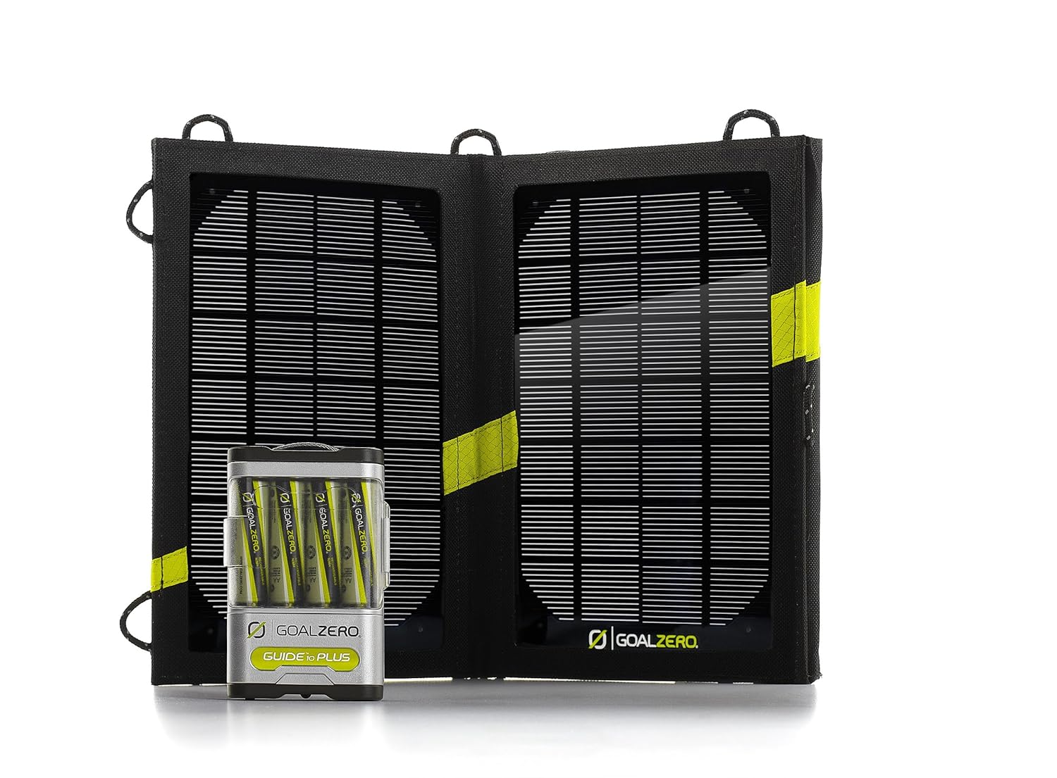

Goal Zero Guide 10 Kit (Nomad 7 Panels): $119.95

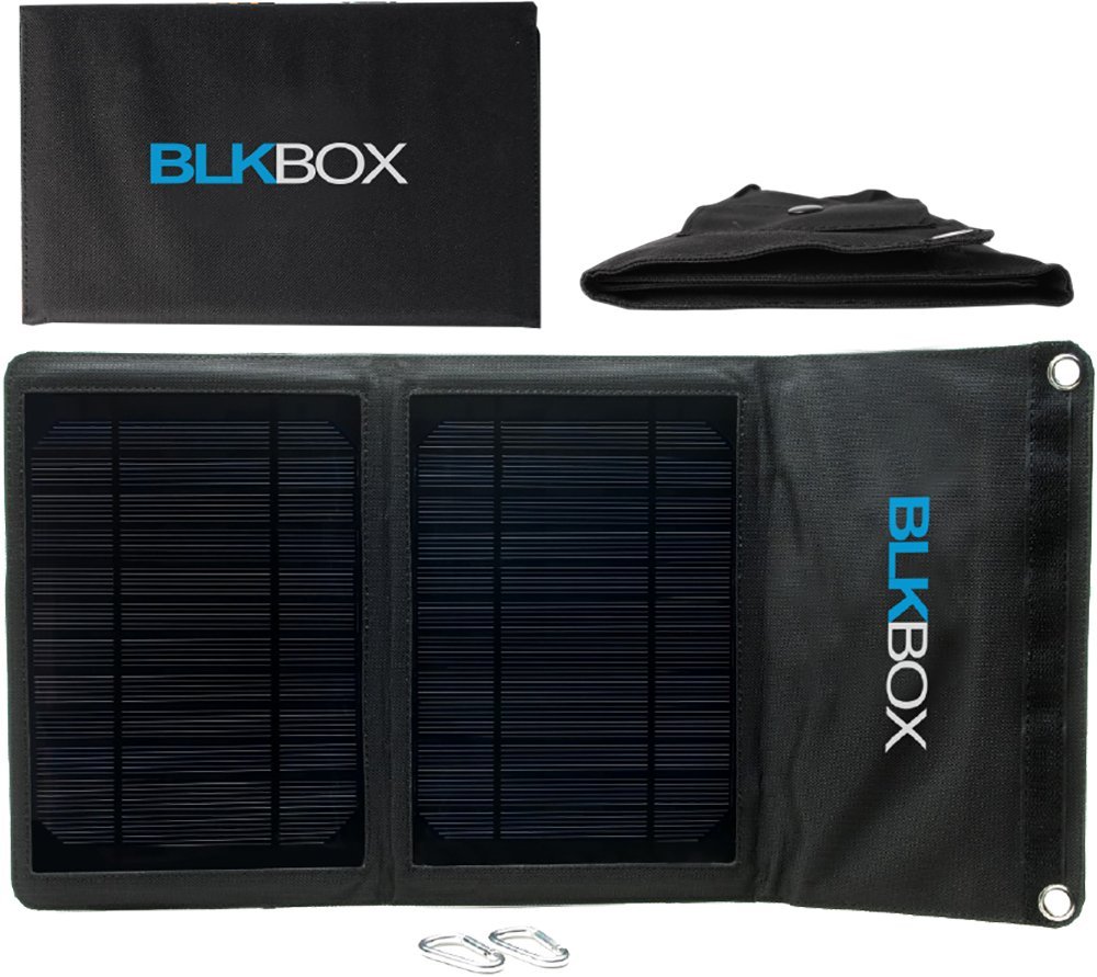

BLKBOX 5W USB Charger: $29.99
BLKBOX 10W USB Charger:  $54.99

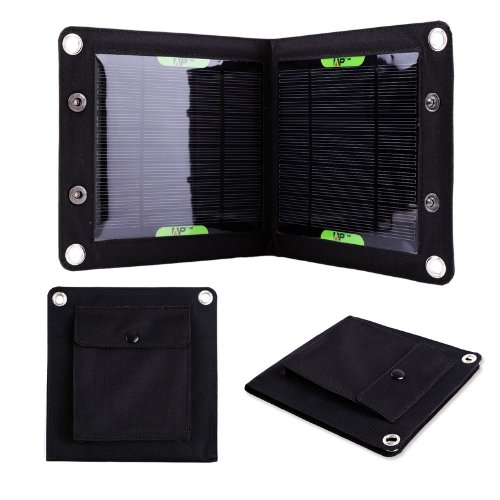

AllPowers 7W Folder: $29.99

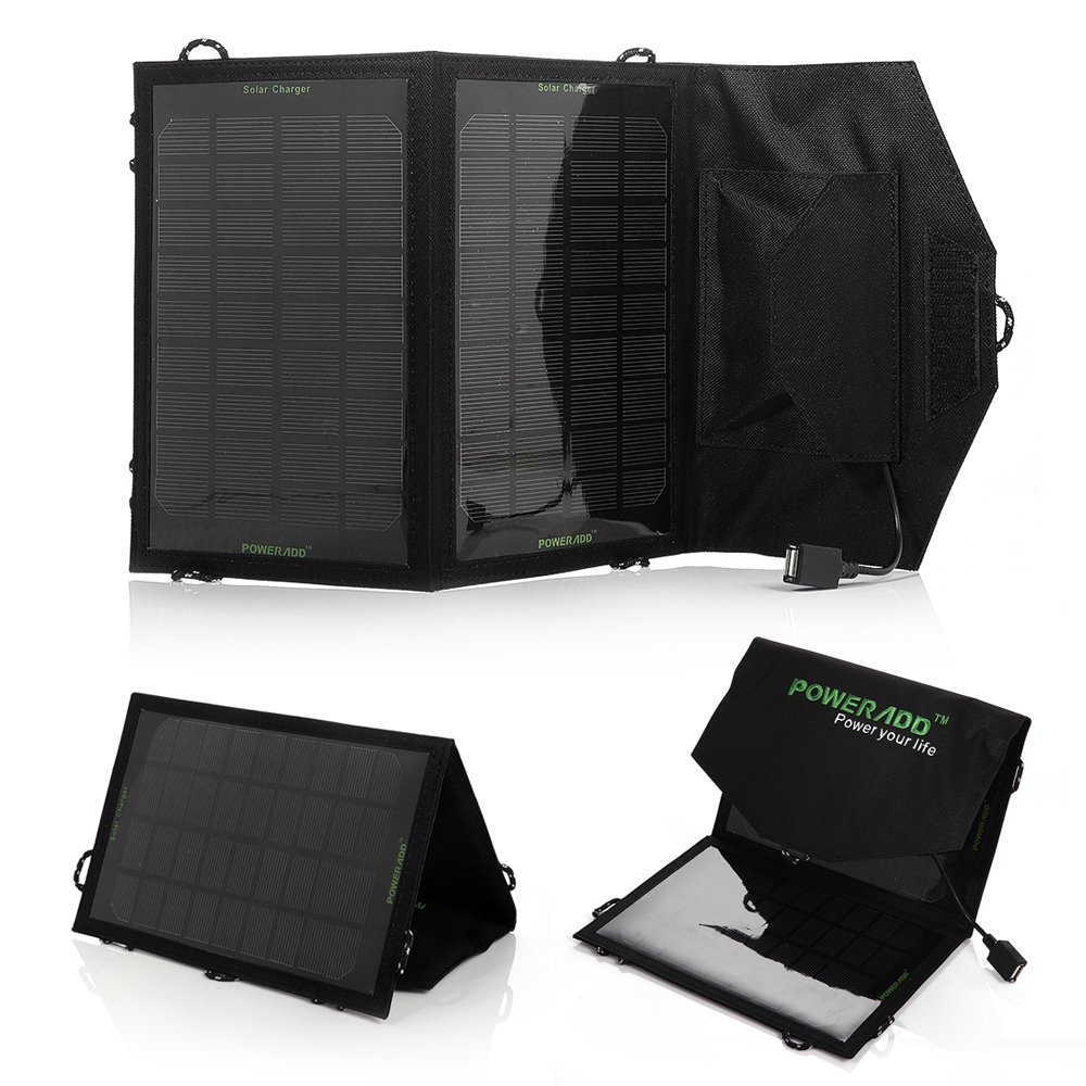

PowerAdd 7W Folder: $29.99

I have the goal zero Guide 10.
I haven't used it much except to test it, but it comes with quite a few accessories (hence the higher price). But I like it and it fits in a smaller pocket of my backpack.
I would seriously question the viability of the cheaper panels.
Goal Zero has a very good reputation.

i have 3 of the GZ guide 10 kits. they work VERY well.
the switch 8 kit is the same 7.5wt panel but uses an 186500 battery pack. better capacity but much longer time to charge with solar. i prefer the AA's as they will full charge most devices i need, charge faster and i can have more flexibility by using the batteries alone in other devices.
with these small systems flexibility is the key along with length of time to charge, cloudy low sun days will be a BIG factor in charging. ALWAYS buy more panel than you expect to need. bigger panels put out better amps with less light.
i am VERY happy with my CZ stuff. i also have a wagan 20wt panel. it works well but the case is SIGNIFICANTLY cheaper material than the GZ and i suspect won't survive much rough usage. the GZ panels are also a bit more flexible than some of the other "hard" kits i have seen which help with damage resistance.

Another plus I can add for the GZ guide 10 kit is that you can (should) use the battery pack USB output for charging your phone, device, whatever WHILE the panel is collecting sunlight.
The battery pack outlet is regulated, and won't vary with sunlight input.
It also comes with the adapter to charge AAA's.
