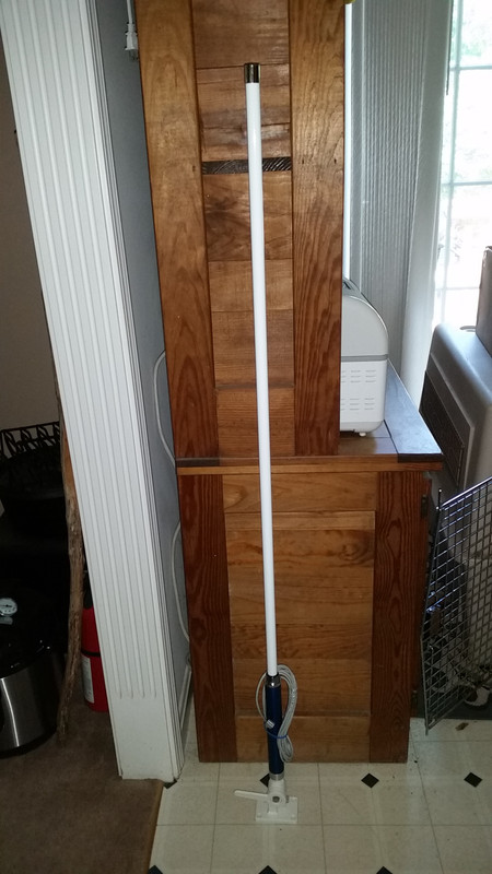

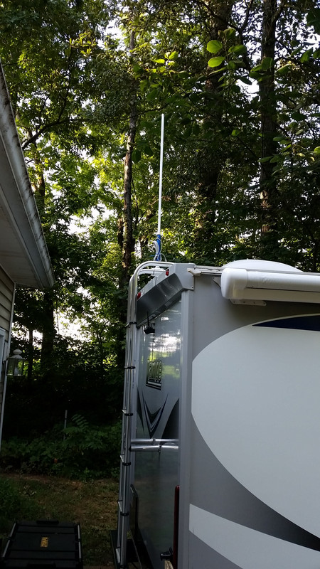

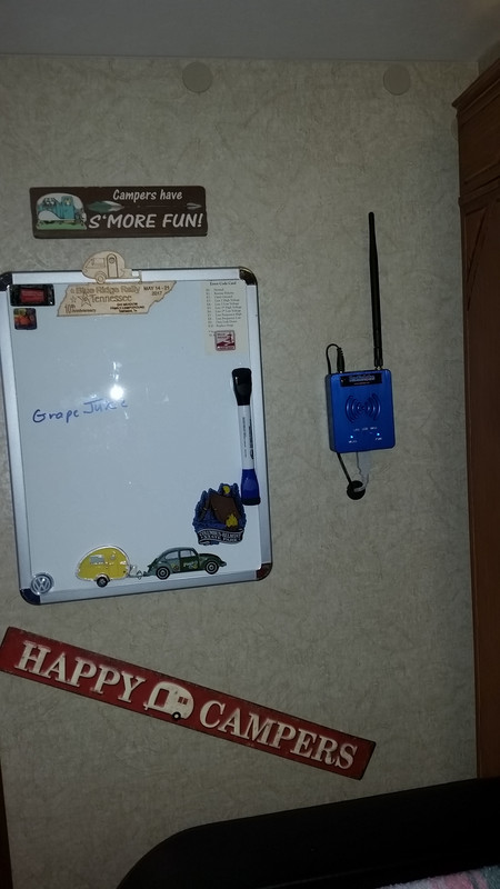

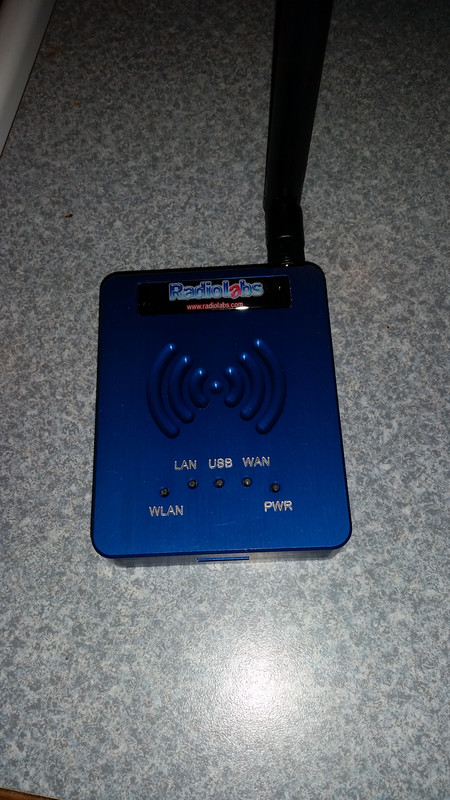

We use a Marine/RV booster from RadioLabs.. It works. More than once, we have connected to a McDonalds or such that was a mile away, because the bandwidth was no good at the CG..
