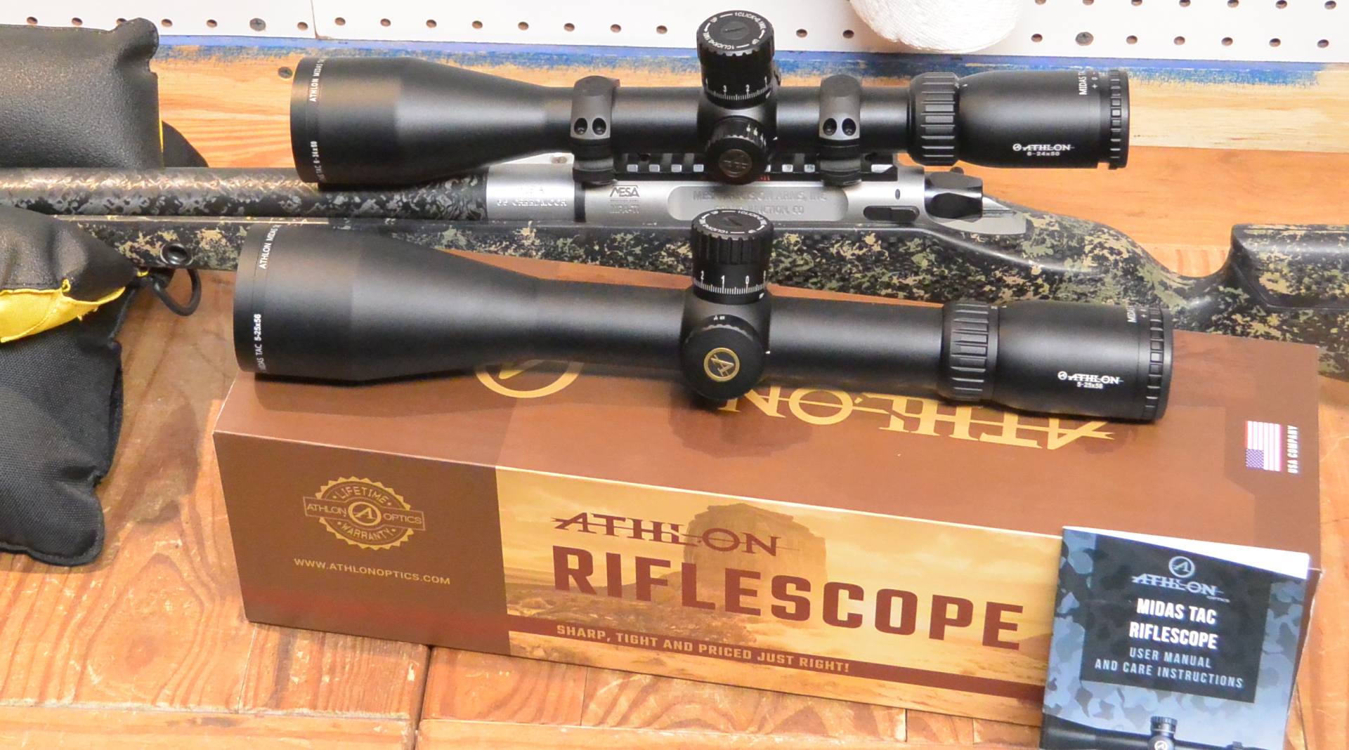

We may as well start the theme of this review right here. There were no surprises in the unboxing. The Athlon Midas TAC 5-25x56 comes with a lens cloth and manual just like its little brother the Midas TAC 6-24x50 did. It is styled very similarly and, from the objective to the tube to the eyepiece, it just appears to be a slightly bigger version of the same idea. The 5-25x56 is about 4oz heavier, just under an inch longer, has a 34mm instead of 30mm tube, and, of course, has a 56mm objective instead of 50mm. Probably, the biggest highlights are the 32mil instead of 25mil total elevation adjustment and the larger 5x instead of 4x magnification ratio.  32 mils is actually a pretty large adjustment range at any price these days, and the Midas TAC 5-25x56 is not a high cost optic.
The manual included with the Midas TAC 5-25x56 I received for testing appears to be the same one as the Midas TAC Athlon Midas TAC 6-24x50 from last year. In fact, its section with scope dimensions has not been updated to include the 5-25x56. I received this scope just before they hit the market generally, so it is likely from the first run and the manual you will receive had not yet been printed. Hopefully they update the troubleshooting section of the new one to remove the suggestion to directly support the barrel with a sandbag, as well as the text about excessive grease in the barrel. There should be no grease at all in a barrel at the time of firing.
Athlon Midas TAC 5-25x56 (foreground) with the TAC 6-24x50 (background on Mesa Precision Arms Crux rifle)

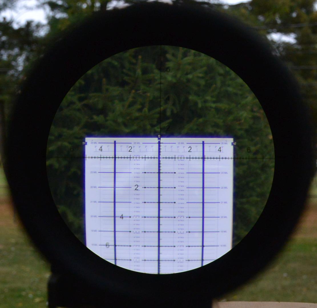

The Athlon Midas TAC 5-25x56 is available with just one mil and one MOA reticle option. The mil option, the APRS3, is a typical mil hash Christmas tree reticle with a floating dot center and .2 mil increments horizontally out to 6 mils then .5 mil increments after that out to 9 mils, at which point there is just a thick crosshairs. Vertically, the reticle is graduated in .2 mil increments for just one mil. At that point, the top half is graduated in .5 mil increments out to 9 mils and then it becomes a thick crosshairs, while the bottom half is graduated in .5 mil increments out to 7 mils, where it goes back to .2 mil increments until 10 mils, at which point it becomes a thick crosshairs. While there is probably some rationale for the alternating use of a .2 mil graduation system and a .5 mil one, this is not fully explained anywhere, though even if it were, I likely wouldn't agree with it over the consistency of sticking with the .2 mil increments throughout. Both vertical and horizontal crosshairs are numbered every 2 mils and are on the thinner than average side when it comes to line thickness. The Christmas tree section has rows of dots every mil below the central crosshairs. Each row is graduated in fine dots every .2 mils and a thicker dot every mil. The MOA based reticle, the APLR4 FFP MOA, has essentially the same appearance as the mil reticle. Unsurprisingly, its graduations are spaced 1 MOA apart. The APRS3 Christmas tree mil hash reticle is very much in line with what I see the industry converging to and the alternation between .5 and .2 mil increments at places is really the only bone I have to pick with it.
When tested, the reticle showed a very slight cant of ~.5 degrees counter-clockwise relative to the adjustments. This is not an amount of deviation I would be concerned about. The reticle graduations were correctly sized.
Athlon Midas TAC 5-25x56's APRS3 Mil-Hash reticle on the HORUS CATS target at 18x

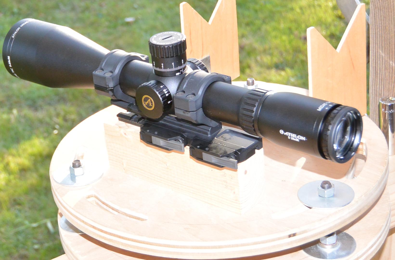

In testing, the scope tracked absolutely dead nuts from 0 up to 17.4mils, returned to zero fine, and then tracked down from zero right on the money to 17.1mils for a total travel of 34.5mils. This travel range is even a bit more than the already generous 32mils advertised. Unsurprisingly, the Midas TAC 5-25x56 also tracked fine to the 4mils each way that I can measure horizontally and showed no zero shift with adjustment of the parallax, diopter, or power ring. The parallax knob even showed exactly 100yds when focused at 100yds and those things are never right.
Athlon Midas TAC 5-25x56 during mechanical testing
