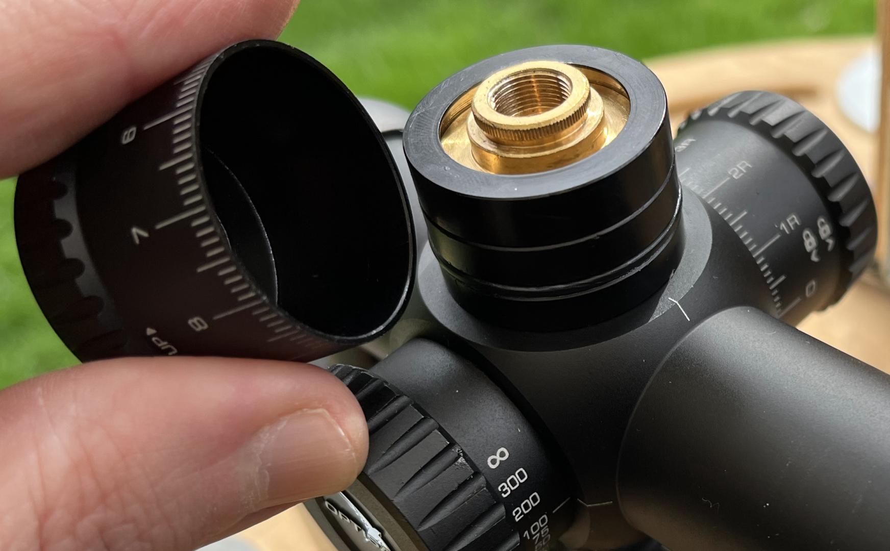

Those adjustment turrets pull up to lock and push down to unlock. The zero is repositioned by unscrewing a cap on the top of the turret, pulling the outer cap up and off, and replacing it at the new zero position. There are no set screws involved in this and there is also no zero stop. The turret feel is very smooth and of higher than average resistance with little tacticle feedback but very loud audible clicks. It is not hard to count your clicks and I did not have any difficulty losing track or having some clicks skipped over. Function and feel of the elevation and windage turrets are the same. Parallax adjustment is in the normal left side position and stretches from 10yds to infinity. Parallax control moves with about average resistance, whereas the power ring is a bit on the stiff side and the euro style diopter is way too loose. You’ll probably want to keep a cap on that or tape in it place to keep it from wandering. The total power ring throw is about 200 degrees and the throw lever stud can be mounted in just one position. In this position, it moves from just below horizontal on one side to just below on the other.
Optisan EVX Gen II 4-16x44F1 turret assembly

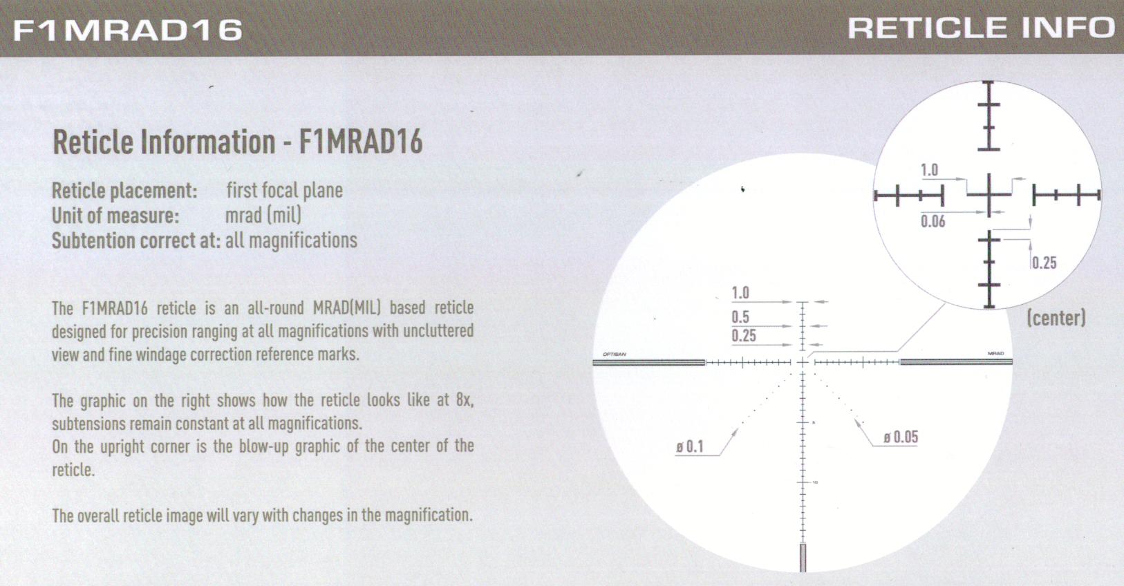

At the time of this writing, the Optisan EVX Gen II 4-16x44F1 comes in one moa / moa configuration and one mil / mil configuration. Each configuration has a single reticle option designated, quite rationally, either F1MOA16 or F1MRAD16. These reticles are very similar in appearance aside from the graduations. The F1MRAD16 one I have features a truncated 12 o’clock post with just 5 mils of graduations above the center, 8 mils of graduations each direction on the horizontal crosshairs, and 15 mils of graduations on the 6 o’clock post with labels for the 5 and 10 mil stadia. The graduations on the reticle are a consistent .5 mils. Lastly, there is a very truncated tree function that has dots positioned only at what you might say are the ends of the tree branches at 1-1, 2-2, 3-3 and so forth to 5-5. Overall, I would say the reticle is an interesting minimalist take on a precision rifle tree style reticle. It doesn’t have as many labels and graduations as I would generally like on a precision rifle reticle, but it is open and intuitive. I think it fits the crossover hunting / precision rifle purpose well. It is minimalist and not confusing, while still having the necessary features and graduations.
Optisan F1MRAD16 reticle diagram
In my test scope, the reticle size was off less than 1% from spec and showed only about .05 mils of cant in 10 mils of travel. This is solid performance and would make the QC numbers for most, if not all, competing scope makers. I should also note there are a couple very, very small particles on the reticle in the upper left quadrant. I do not think they are dust as they are way, way too small. I expect they are tiny specs of whatever is being used to fill the reticle etching. The particles were small enough I did not notice them the first several times I used the optic, only later against a white background.
