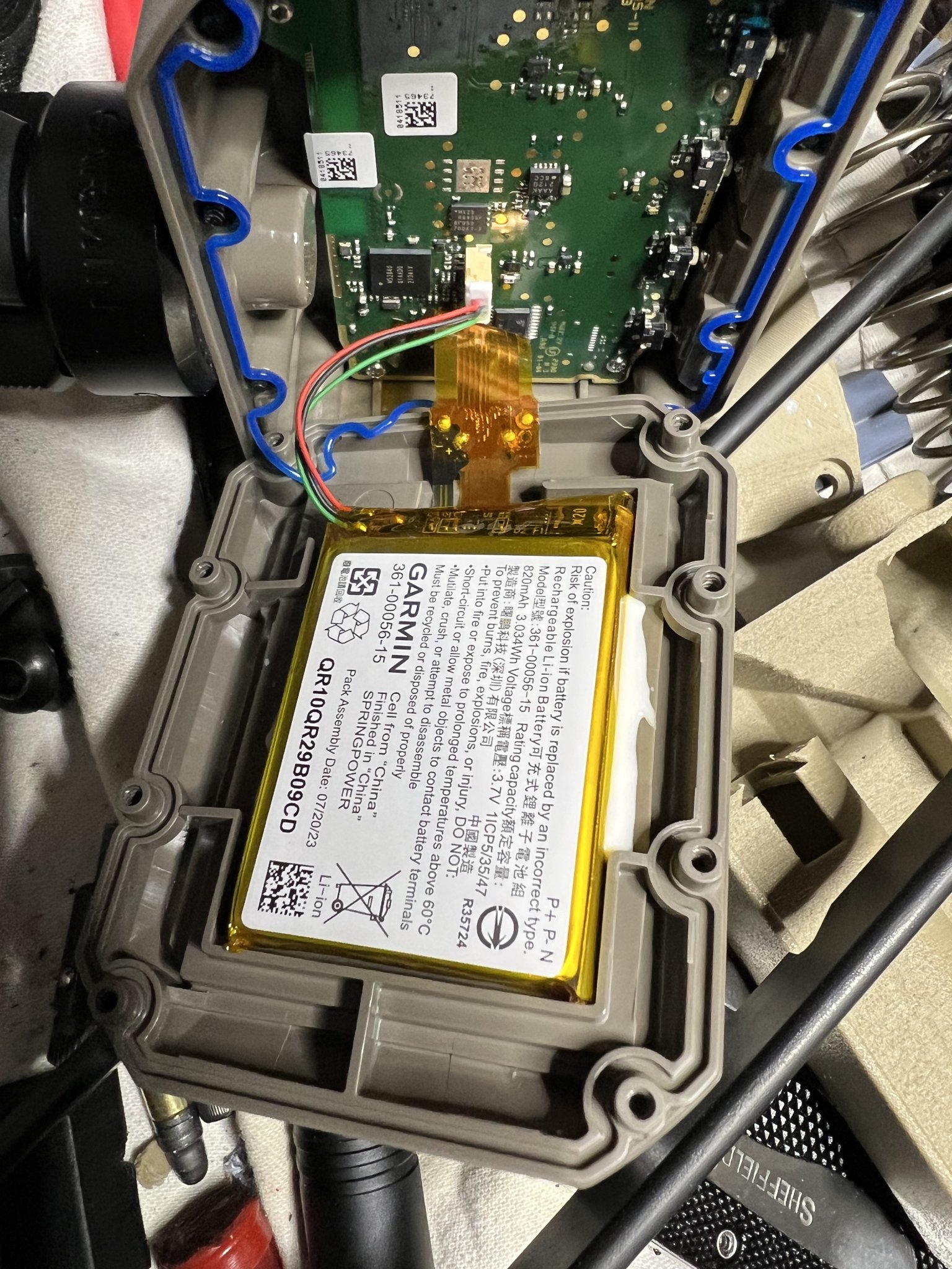

Thanks to Hide.TV user JT526 for this picture of the Garmin Xero C1 Pro battery arrangement

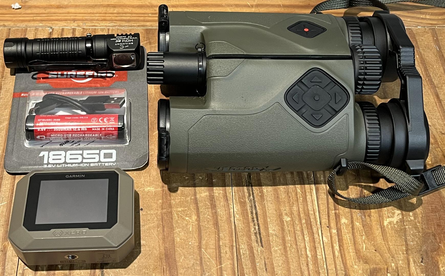

Now let’s get to the biggest poor design decision. As you may have guessed, the battery is unfortunately not of the easily replaceable variety. It is a rechargeable internal lithium ion like many cell phones have. You have to partially disassemble the chrono if you need to get at it. Additionally, Garmin does not offer a battery replacement service, nor do they directly sell replacements. Fortunately, some of our handy forum users have done a little reverse engineering and found the battery to be a fairly standard sized (at least for the moment) 820mAh 3.7V battery pack that can be had online for around $25. There does appear to be some ungluing involved in a battery replacement, so care would need to be taken not to damage things, as the battery appears to be glued on or near the back of the display. I have checked with Garmin and the battery and chrono do not include any pernicious anti-third-party repair prevention software to prevent replacement. In summary, an eventual user battery replacement is possible, but is not as easy as swapping out an 18650 lithium ion cell. Additionally, in the event the Garmin chrono has a dead battery, whether temporarily or permanently, the unit can be run using an external power pack attached to the USB port. This is also an excellent mode to run the unit in if you need more than 6 hours runtime, such as if you’re commercially using it in a test range. Lastly, replacing the battery in the Garmin Chrono yourself will void the warranty, but that is really not much of a concern as its warranty is only one year and it’s pretty unlikely the battery will die in that span. Speaking of those 18650 batteries they should have used, the 18650 is a rechargeable standard of lithium ion battery that would have been a great choice for this device. They are the same chemistry and resulting voltage as the Garmin internal battery and are widely available from very high quality brands for $10-$20 a piece. They are even the right size to have easily incorporated in the design. Most of us already have them because that is what most rechargeable headlamps run on. As a bonus, 18650s have around a 3,500mAh capacity and so would provide 4x the amount of runtime as the chosen 820mAh internal battery for a minimal increase in the size of the resulting device. There is really no excuse for this internal battery design. This is not the cell phone industry. I expect most shooters intend to keep these devices longer than average lifespan of a rechargeable battery and value easily replaceable wear components.
Garmin Xero C1 Pro Chronograph with the 18650 battery it should (but does not) use and a headlamp and Vectronix Vector X laser rangefinding binoculars that wisely do use 18650 batteries

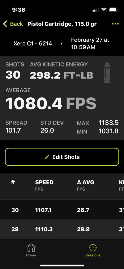

The Garmin Xero C1 Pro Chronograph can interface with both the Garmin ShotView phone application specific to this product and the multi-product Garmin Express PC application. In theory, ShotView can carry out all the functions necessary, but as we will see, it has some issues.
Garmin ShotView app during my first range trip to an indoor handgun range with the unit Garmin Xero C1 Pro Chronograph
The Garmin ShotView phone application is intended to add significant functionality to the chrono as well as handle firmware updates and allow you to store your data in your account in the Garmin cloud. Installing the app unfortunately does require you to set up a Garmin account to facilitate this cloud storage when you install even if you opt out of the cloud storage feature. You can do everything in the app that you can do on the device itself in addition to a number of other things. If you are using the app while recording shot strings on the chrono, the shots will also update in the app. In the app, you have additional labeling functionality, such as changing the name of a shot string to add more detail or writing notes to be saved with the string that might include information like atmospherics or load data. This is pretty important stuff for your data record. In the app you are also not limited to the 50 strings of 100 shots each data storage maximum the device itself has. The chrono itself appears to have only 56megs of internal memory, no slot for more, and a hard limit of 50 strings even if those strings are only a few shots each. After that, you are prompted to delete a string each time you want to add a new one. Given that your labeling of strings in the device is very limited, this is probably plenty of capacity, as I’m sure you can’t keep track of what each string was anyway. The app does not have these limitations and so you can feasibly keep a record of all your sessions there with notes on what each string represents. The app also allows one to export this data into a CSV file that you can e-mail to yourself if you want another way to keep your records, which is a nice feature.

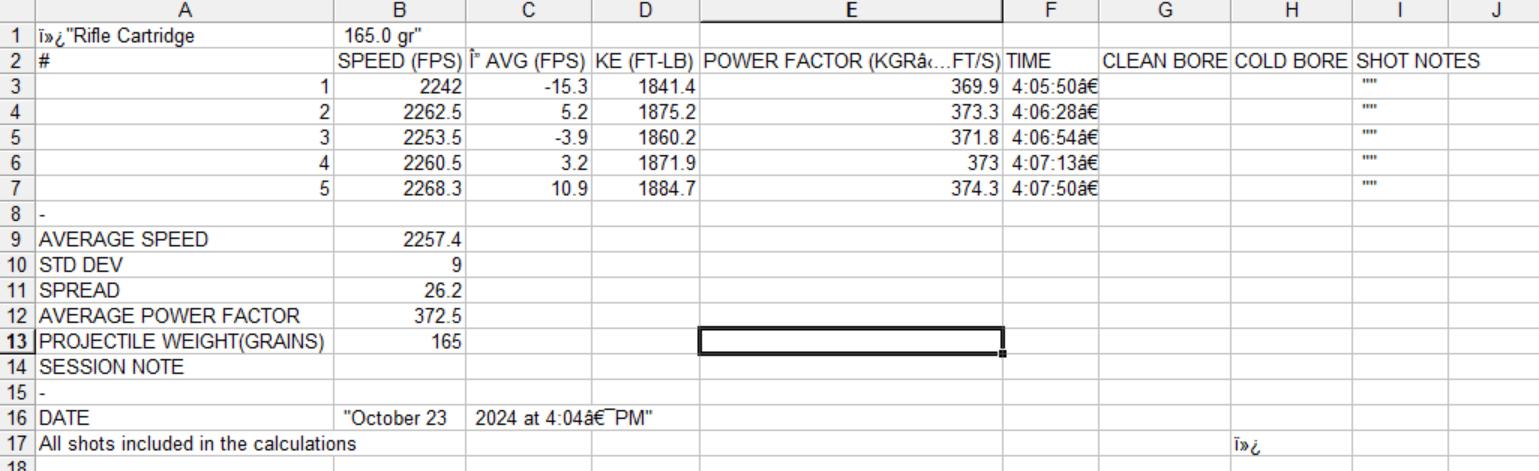

Example Garmin Xero C1 Pro Chronograph shot string exported from ShotView to a CSV file
The issue I have with the Garmin ShotView app is not its functionality, but rather that it has some bugs. It is supposed to automatically update the firmware in the chrono whenever there is an update, but mine didn’t accomplish this and so I needed to download the Garmin Express app for the PC to accomplish a firmware update. The PC app doesn’t have any other functions with the Xero C1 Pro Chronograph. It just updates the firmware and adds itself to Windows startup, as it evidently thinks this once-in-a-blue-moon function justifies automatically running every time you start your PC. The ShotView smartphone app also struggles to complete a number of its other tasks and is prone to crashing. It is supposed to pull new shot strings that were taken when the app was not connected to the chrono from the chrono when it reconnects but it struggles with this and appears to pull just 3 or 4 new strings each connection before inexplicably stopping. If you try to hit the refresh under the device screen, the app then just locks up and needs to be restarted. I guess I will eventually have all my strings pulled over, but in 5-6 connections they are not all there yet. I appreciate the added function the app gives the chrono, but as feels pretty par-for-the-shooting-industry-smartphone-app-course, it is buggy.

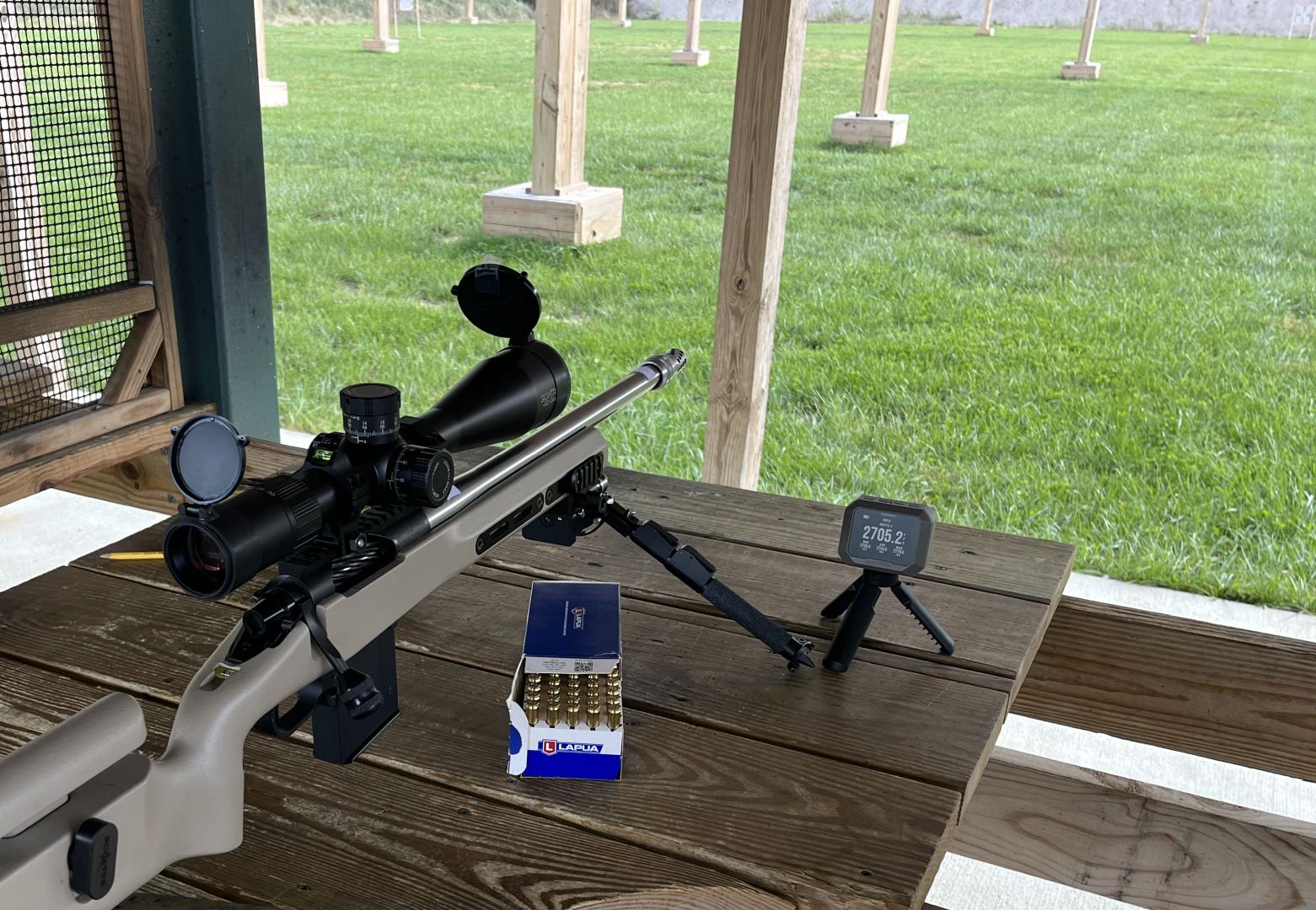

I have now used the Garmin Xero C1 Pro Chronograph at a wide variety of ranges with a variety of both handgun and rifle cartridges for more than a thousand rounds. I’ve used it on .22lr (waxed with rifle and bare lead with handgun), 9mm, .223rem, .308win, 6.5cm, 45-70gvt, and 350L. In this lineup, only the .22lr is particularly challenging for many chronographs. I recommend this PrimalRights video if you’re interested in seeing performance data from some exotic and challenging cartridges. In my testing, I’ve used the Garmin chrono on crowded shooting lines and all alone. I’ve used it standing, seated at a bench, and prone. I’ve used it positioned properly the correct distance from the muzzle and I have used it sitting on that little fold-down table indoor ranges have which is nowhere near as close to the muzzle as the Garmin recommendation.

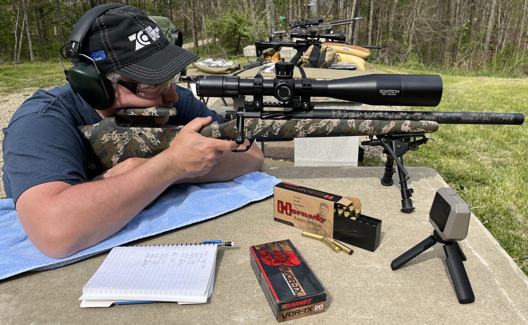

Garmin Xero C1 Pro Chronograph on its first range trip with the PurePrecision SKLTN 350L build and Sightron S6 5-30x56mm scope
For the rifle rounds, I have always properly positioned the Garmin and it has never missed a single round. It has also never improperly recorded a round from the lane beside me, though it has had ample opportunity. This is simply remarkable. It just plain works, all the time. It is not finicky or temperamental. In fact, it has even picked up the vast majority of handgun rounds I fired rapidly at the indoor range with the Garmin sitting on the little range table way below where it was supposed to be positioned relative to the muzzle and with only about 20ft of distance to catch the projectile in before the target. I have also talked to a number of folks who have attached the Garmin on brackets to their rifle so they could record while actively moving from barricade to barricade. Despite the Garmin not being labeled for this, they have had good function and not experienced breakage. The Garmin simply works. It even works in a lot of situations where you aren’t following the directions.
