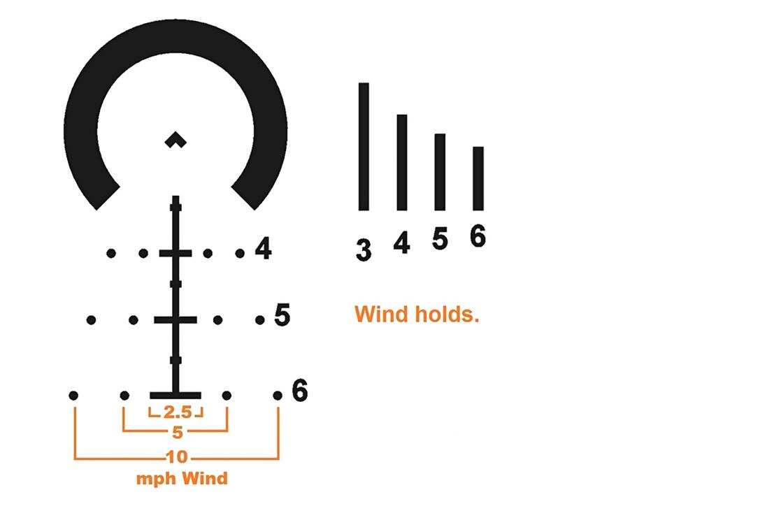

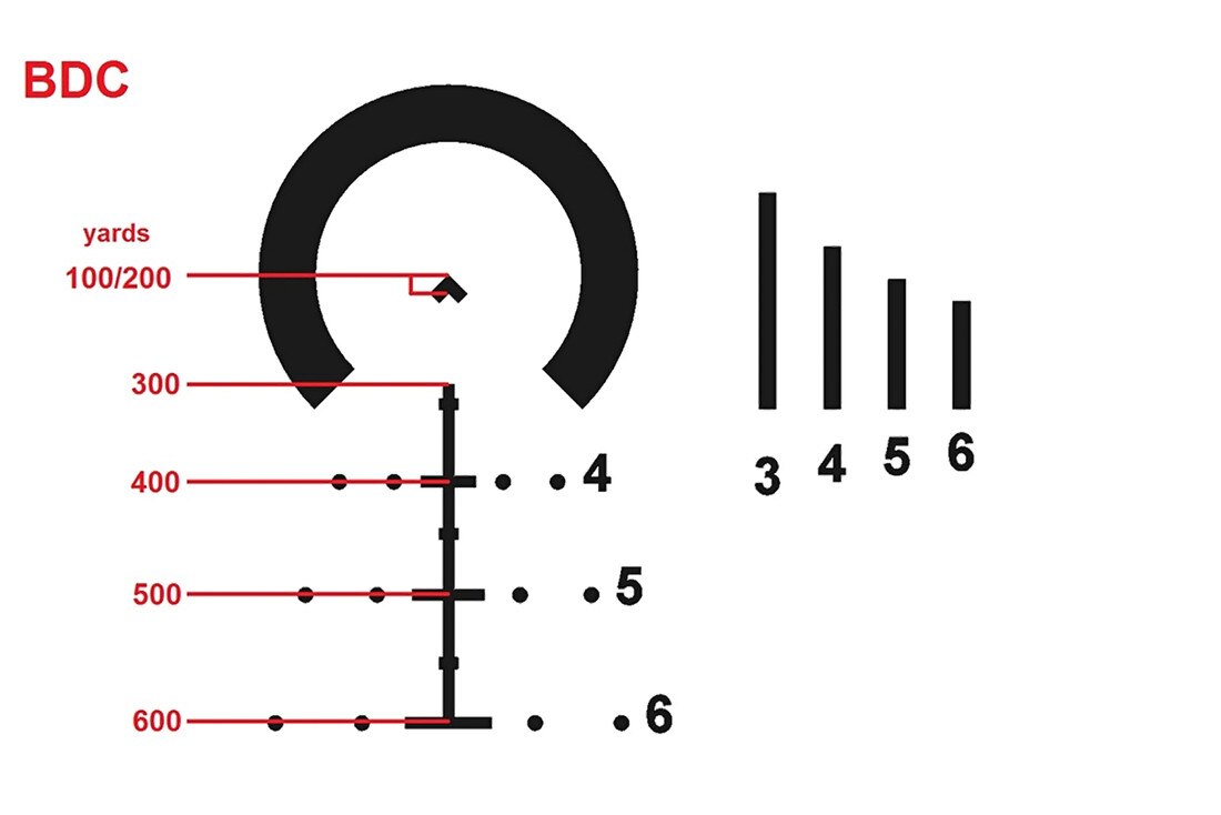

Mostly stands or a seated ground location for hunting deer along tree lines around open fields. The target shooting is more for practice and fun. BDC or non-BDC, fixed or variable power, christ this annoying as hell. I may just end flipping a quarter to decide if I go fixed or variable and do the same for the other decision regarding the scope specifics after that ![]() 1. Zero at your preferred distance - 100 yards or meters is pretty common, but it's not a requirement, then put the elevation and windage needed for a particular shot on your Mil or MOA finger adjustable turrets. 2. Establish a basic zero at some intermediate distance and then use the hash marks on a Mil or MOA reticle to adjust for longer or shorter shots. For example, if you're using a Federal 165 gr Sierra Game King in your .308 at 2700 fps, and zero at 250 yards, the bullet will be within 3 3/4" of the line of sight out to about 285 yards. You'd then hold 2 MOA high at 300, 3 MOA high at 350 yards, 5 MOA high at 400 yards, 7 MOA high at 450 and 9 MOA high at 500. 2, 3, 5, 7 and 9 MOA is easy to remember. 3. Use a BDC reticle. The BDC requires you to zero at a specific distance. The reticle is also designed for/limited to a specific load or class of cartridges, and unless you take care to ballistically match the load to the reticle, it's not as precise as either of the other methods. Number 1 is precise, but requires you to either generate the required ballistic data or memorize the come ups at various ranges, and it's a bit slower if you are engaging targets at different distances. Number 2 is very flexible but again requires you to either generate the required ballistic data or memorize the correction needed at various ranges. It can however can be done very quickly, if you memorized the corrections. Number 3 is not always that precise, you're limited by the maximum range allowed by the reticle, and the magnification has to be factored in of you're using a second focal plane scope. But short of screwing up the magnification on an SFP scope, or using a cartridge that is not all that consistent with the reticle, it's fast and pretty idiot proof. A scope with adjustable turrets can be used for either option 1 or 2, and a scope with a BDC reticle AND adjustable turrets can be used for option 1 or 3. With a Mil, MOA or BDC reticle you still have the option of correcting for a missed first shot, by making the correction using the reticle - but it's easier and more precise with the Mil or MOA reticles. ---- Honestly, given 400 yard ranges and your style of hunting - stands or still hunting over open field, where observation is a key element, just get a 10x fixed power scope with a Mil or MOA reticle and matching Mil or MOA turrets. If you think in yards and inches, get the MOA reticle. If you think in meters and centimeters, get the Mil-dot reticle. In other words, do you consider a white tail deer to be 15" deep in the chest, or 38 cm deep in the chest? If you said 15", get an MOA reticle - it'll make life simpler and you'll shoot better. You can then use the reticle itself for ranging and inside 600 yards or so, it will be plenty accurate enough for your purposes. You can also then either use the Mil or MOA hash marks to hold off the target for windage and elevation, or put the dope on the scope and shoot with the cross hairs on the target. |
