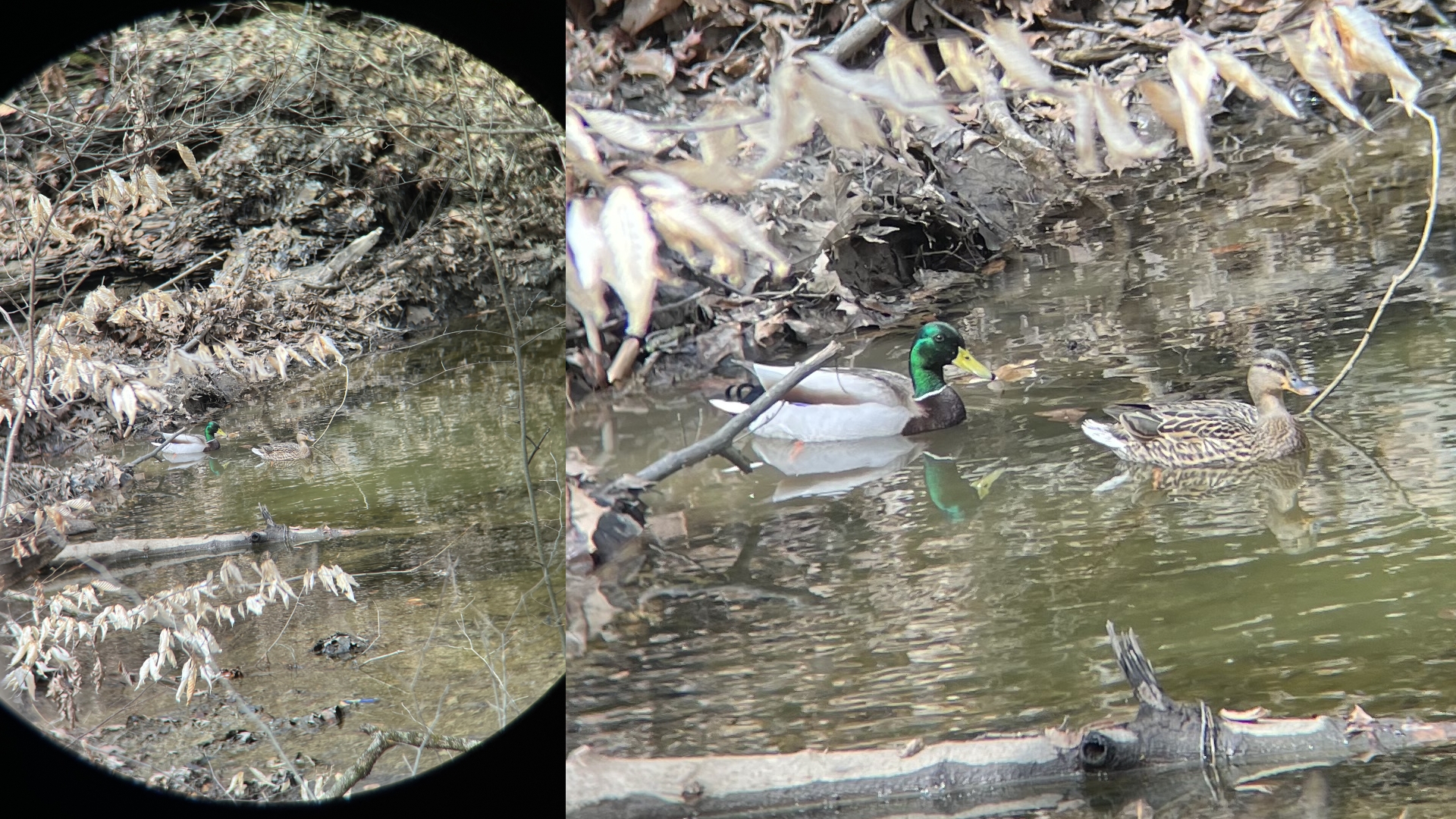

Without question Leica has done an impressive job when it comes to the optical performance of the Geovid Pro 32 binos. There is no noticeable color tint at all in the image, yet the display is readable in most conditions without the user covering the objective with one hand or re-aiming the binocular at something darker. Furthermore, even in the challenging super bright conditions with a light tan or gray background where you might need to cover the objective or look at something else to read the display, you can still make out the aiming reticle well enough for ranging the target. Leica clearly preferred the optical performance end of the trade-off over the display performance end, but they did not go so far in this direction as to give you real issues in any conditions. I think they did quite well calibrating this.
Through the lens photos are typically a poor measurement of optical performance and often come out poorly, but this one through the Leica Pro 10x32 LRF binos sure came out well
As for the unavoidable light absorption you get with LRF binos, you will not notice it in daytime even if it is rainy and overcast, but as the light fades in the evening, these Geovid 32s become noticeably darker than comparable quality non-LRF 32's and this is especially so in 10x configuration. I should note here that Leica unsurprisingly has 42mm Pros slated for production sometime next year. Going with 42s over 32s is the obvious choice if low light performance is more important to you than size and weight, jJust as the 32s are the obvious choice for size and weight. For my part, the 8x32mm form factor was my preference for binos before these and the percent light lost due to these being laser rangefinding has not changed that.

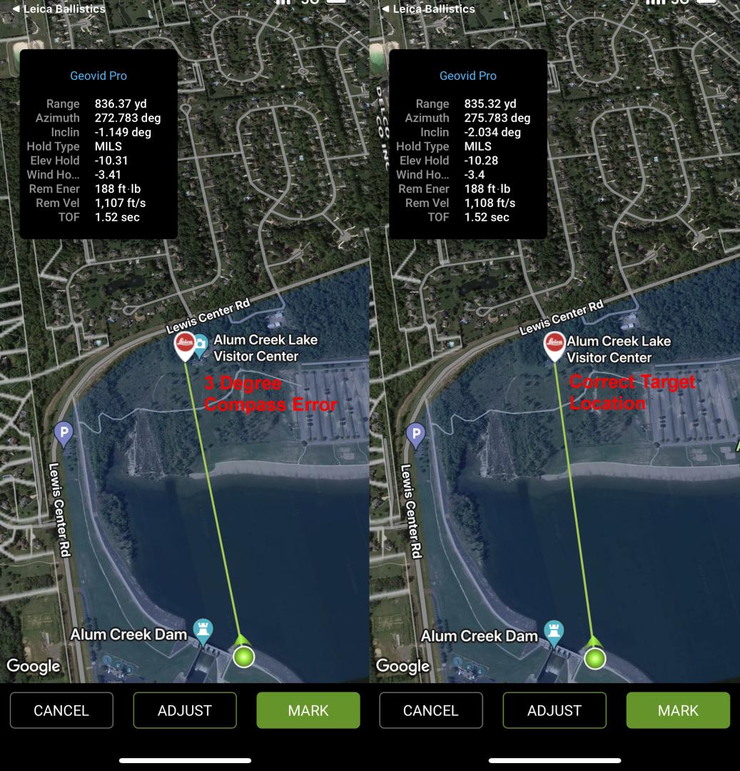

With this generation of laser rangefinders, Leica and a few other makers have introduced the ability to mark the location of a ranged point in GPS software. At the time of this writing, BaseMap is the only choice for doing this and doing so requires the paid subscription version of the BaseMap software. Google Maps and Garmin are also mentioned in the Leica advertising literature in conjunction with "ProTrack" but at this time there is no integration of this function within those software packages and the Leica ballistics app does not itself have mapping functions.
The idea of Leica ProTrack is to help the hunter to find the start of a blood trail. Often, after an animal is shot, it goes some distance before it dies. Because animals do not understand what being shot represents, they do not usually go far if they are not actively chased because they neither understand they are dying, nor that they are being hunted. They just feel hurt, then weak, and tired. As such, after delivering a shot, hunters typically lay low and wait a while to start tracking the animal so that it will not likely go far before bedding down and dying, so they won't lose it. It is therefore quite helpful to have an accurate point to start your search for a trail and this is not so easy when the game starts 500yds from you and you have to wait a while before starting to track it. Things can look a lot different standing in a field than looking at that field from 500yds. It can be hard to find your starting point and that is what the idea is behind ProTrack and similar remote point mapping functions.

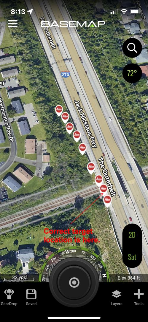

Prior to doing this review, I had not noodled with the BaseMap software at all. I had heard of if from people using its satellite map to estimate ranges to targets by bringing up a map of the range and dropping points on the map where it thought the targets were, but I hadn't actually tried it. I found it a slick software package. It has lots of functionality around creating routes, measuring distances, and marking campsites, gear drops, and other important points. BaseMaps also is designed to be used without access to a cell phone signal. This is an important consideration, given that the locations having the best hunting and hiking rarely offer cell service. This also gives the Leica Geovids, and other makers’ products that interface with Basemaps, the advantage of working without cell service, whereas Swarovski's similar feature uses its own proprietary software and requires a cell signal. Most importantly from the standpoint of my use, BaseMaps interfaced quite easily with the Geovid binos.
Within BaseMap, mapping points while ranging them is found within the BaseMap software under tools and is called "Remote Marker".  Once you have paired your binos to the software, hitting this function will prompt you to range what you want to mark. When you range, the point will show up on your map with a line from where you are standing to the ranged point. You can then choose to place a marker at that point, manually adjust the marked point’s location, or just dump the point. The software uses three data inputs to decide where the point should go. These are the user’s location determined by your phone’s GPS, the distance and angle of the point from the user determined by the binos, and the Azimuth of the binoculars, determined by the compass in the binos. The first couple of inputs are quite good. Typically, outside the GPS is good to within about 3yds, the range within 2yds, and the inclination within a degree and a half or so. In my testing, however, the Azimuth was only good within 9 degrees or so. This can easily mean 50-100yds of error on a longer shot.
Consecutive remote markers for the same ranged point
Potentially being off by 50-100yds on a target’s location sounds bad, but, fortunately, this is not a random error and we are not talking about an area of uncertainty as much as a path of uncertainty. There is very little uncertainty in either the user’s starting location or the distance of the target from the user. Therefore, you can pretty easily mark out an arc-shaped path of possibility and just walk it from one end to the other. You can do this by ranging and marking the same point 5-10 times. All those points will line up on a gently arcing path. Its no nice, clean, single pinpoint, but it is still a tremendous aid in helping you find the animal’s trail. Frankly, the software should probably just mark an arc for you on the map instead of a single point. This would save you from having to mark the same point 5-10 times, and I believe is what Swarovski actually did.
A Series of Remote Markers all Generated by Ranging the same point. Note that they Represent an arc on which the Correct Point lies

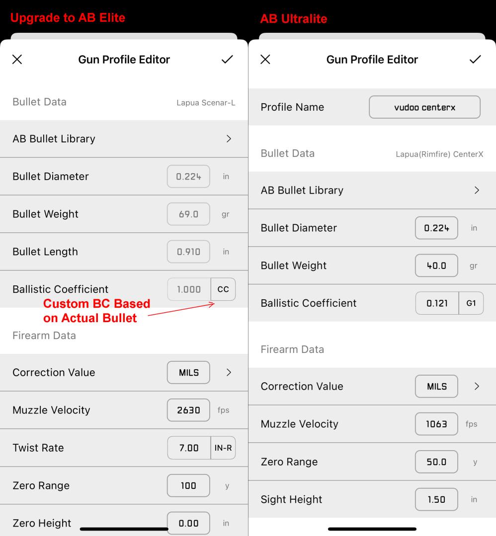

Leica Balistic App Profile Creation Page, Elite vs. Ultralight
Of interest for those who own the last generation .com binos and monoculars, Leica has made available to you an upgrade to Applied Ballistics’ Ultralight software with the switch over to AB software from Leica’s previous in-house suite. I am quite impressed with this degree of after-the-sale service:  Leica certainly didn't have to do this. Those with the older product will get this upgrade through the new Leica Hunting app. Those with the new Pro units download the Leica Ballistics app. You should note that the old products unfortunately cannot be upgraded to AB Elite and their underlying calculations are not changing. This is essentially an upgrade in user interface and also an upgrade in bluetooth functionality and stability. A good deal of the reason for Leica switching to AB from their in-house software was actually user interface and bluetooth driven. AB has been doing ballistic solver apps for some time now for a number of parties and has become the industry leader in the field.

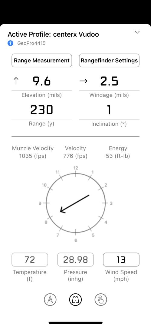

I would love to say that these Leica Pro binos had the first ever shooting related smartphone app to just work flawlessly for me right out of the box. This was a longshot, given the first version of the app I had was actually a beta version and it didn't happen. There was actually something of a saga and this is much of why you’re getting the review now and not a month ago. The experience left me with an impression of just how quickly and responsively AB got to work on reported issues, as well as just how beta that beta software really was initially. The first issue I had related to ballistic software ironically wasn't even software related. The first test binos I got just had a bad bluetooth chip and couldn't maintain a steady connection to the phone. This manifested as an inability to upload any ballistics and getting conflicting messages concerning whether the binoculars were connected to bluetooth or not.
Once I got the second set of test binos,  with working Bluetooth this time, I got down to running through the software. One of the first issues I encountered was what seemed a particularly persistent default, or perhaps a test profile for a 1-11.25 twist rate 175gr .308. All or part of this profile occasionally created itself or creeped into profiles I was in the process of making, replacing values I had specified with its own. Evidently, this issue showed up in the Sig 10k's AB software as well. At the same time as I had the persistent 175gr profile issue, the sub-menu for muzzle velocity calibration and drop scale factor calibration was not working properly. My .22lr, for instance, got a calibrated muzzle velocity of 1.3million FPS. This is a bit more than the 1063 fps entered and quite a dramatic reaction to the tenth or two mil adjustment needed to true the model to my field data. After sending this information in, AB had an update out in a few days that banished the ghost .308 profile and the million feet per second calibration. The calibration was still off, though, in each profile I tried it on. So I sent in another message. The turnaround was even quicker this time and the calibration feature seems on point now. Interestingly, the actual profiles themselves never amiss during this process. It was more like the underlying AB engine was not totally coupled properly to the new Leica specific UI. Lastly, I found a bug wherein just part of a ballistic profile could be transferred to the binos. This resulted in a profile name and initial velocity from the new profile but the actual calculations from the old one. Not so good. Turnaround time on this one was a bit longer. A couple of weeks. It has been mostly remedied with an update earlier this week and will be completely fixed with the 1.1 update Monday. At this juncture, the partial transfer only occurs if you switch the active profile in the app when the binoculars are not turned on. In such case, when you turn the binoculars on, only a partial transfer (initial velocity and profile name) will occur.

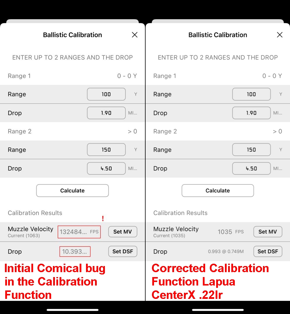

Update 8-22-2022
Leica has released the Ballistics 1.1 update along with an associated firmware update for the binoculars themselves. This update fixes the potential for an incomplete ballistic profile transfer when the profile is changed in the app at a time the binoculars are not active. With this fix I am unaware of any current glitches in the software for the Geovid pro binos. Yay.
Also, The software update for the older .com models to using the newer Ballistics app has been delayed. They are thinking maybe October or so on that.
Lastly, the guys at AB have been furiously and regularly adding personal ballistic profiles to their library. There are a great deal more of them available now and many are not just duplicates of the 105gr 6mm Berger hybrid. Particularly juicy now is the .22lr section and the ELR type large bullets though there are a number more 6.5 and .308 bullets as well. The personal data models are beginning to be a very nice source and include a number of bullets for which a custom model had not previously been done. All of these models are available to all the AB elite users including both those who bought it through an upgrade to their Leica Geovid pro's and everybody who bought Sig 10k's as it is standard on these.
Initially the Calibration Function in AB's Elite Software was a bit buggy. They fixed it quite quickly.
I have found this Leica skin, flavor, version of UI for AB's underlying software quite nice. The menu options are simple, intuitive, and clean. So far I have pretty much found what I'm looking for quickly and easily. The Elite version differs from the default ultralight in offering a few more options, but with a layout that is basically the same. The biggest differences are that AB Elite does not limit solutions to 800M, includes custom and personal models for many bullets, has an adjustment for sight scale factor, has a feature for truing the muzzle velocity to your field data, and includes a second calibration for drop scale factor to true to your data and improve ballistic solutions beyond supersonic. I understand the calculations also add in a few other environmental factors as well. I think this included spin drift based on a wind you input and Coriolis.  I poked around a little in the Custom and personal ballistic models to see what they have. In the Custom models they have a good number of common long range precision bullets in common calibers, but are by no means complete. When you wander away from the more common long range precision stuff to hunting bullets, for instance, the library gets thinner. You can switch to the Leica library, though this is not a custom model but rather just G7 based, and of course you can go the old-fashioned way of entering all your own bullet data manually if, as with the very nice 130gr 6.5CM Norma Scirocco hunting rounds I have some of, they don't have the bullet in any database. However, there is also a tab to request a bullet, which will bring that bullet to the attention of the AB guys and flag it for potentially getting its own custom model, as AB is constantly adding new custom models. Perhaps I'll do that on the Norma stuff tonight and see if a custom model beats this article to press. The request feature seems like a rather nice addition. As for that library of personal ballistic models, well, they’re all in there. Basically, all of them are based on a couple Berger and Hornady 6mm bullets. So, you end up with 500 or so very similar models you could choose from for a 6mm Berger 105gr hybrid. Gee, I wonder what competition shooters are using. These models are no doubt useful to the competitors who made them at events, but making them publicly available is of very limited usefulness and high redundancy.

The Phone Readout in Ballistic Mode when Ranging while Connected via Bluetooth
First off, when you range in phone-connected mode, all values immediately show up on the phone’s screen. So, if you have the phone mounted to an arm band or your rifle, or perhaps the spotter has the bino and the shooter the phone, the data is all up on one screen there immediately. In case you ranged the wrong object, you can now also interrupt the previously uninterruptible display cycle by hitting the range button again. This has been changed based on user feedback just since the launch a month or so ago, and it is certainly welcome. You can initiate the re-range as soon as 1.5seconds, as laser output regulations will not allow for faster emission of full power pulses. If you have a target you think will be tricky to range though, you can hold down the range key to produce a quick succession of lower power range returns releasing the key to get the ballistic solution once you hit a range number that looks like the right one. Lastly, Leica is considering adding options to allow the user to change order and duration on the current cycle of in-bino solution screens. Currently you get two cycles of two seconds for the range, two for the drop solution, and two for the wind-based a wind value you entered into the app.

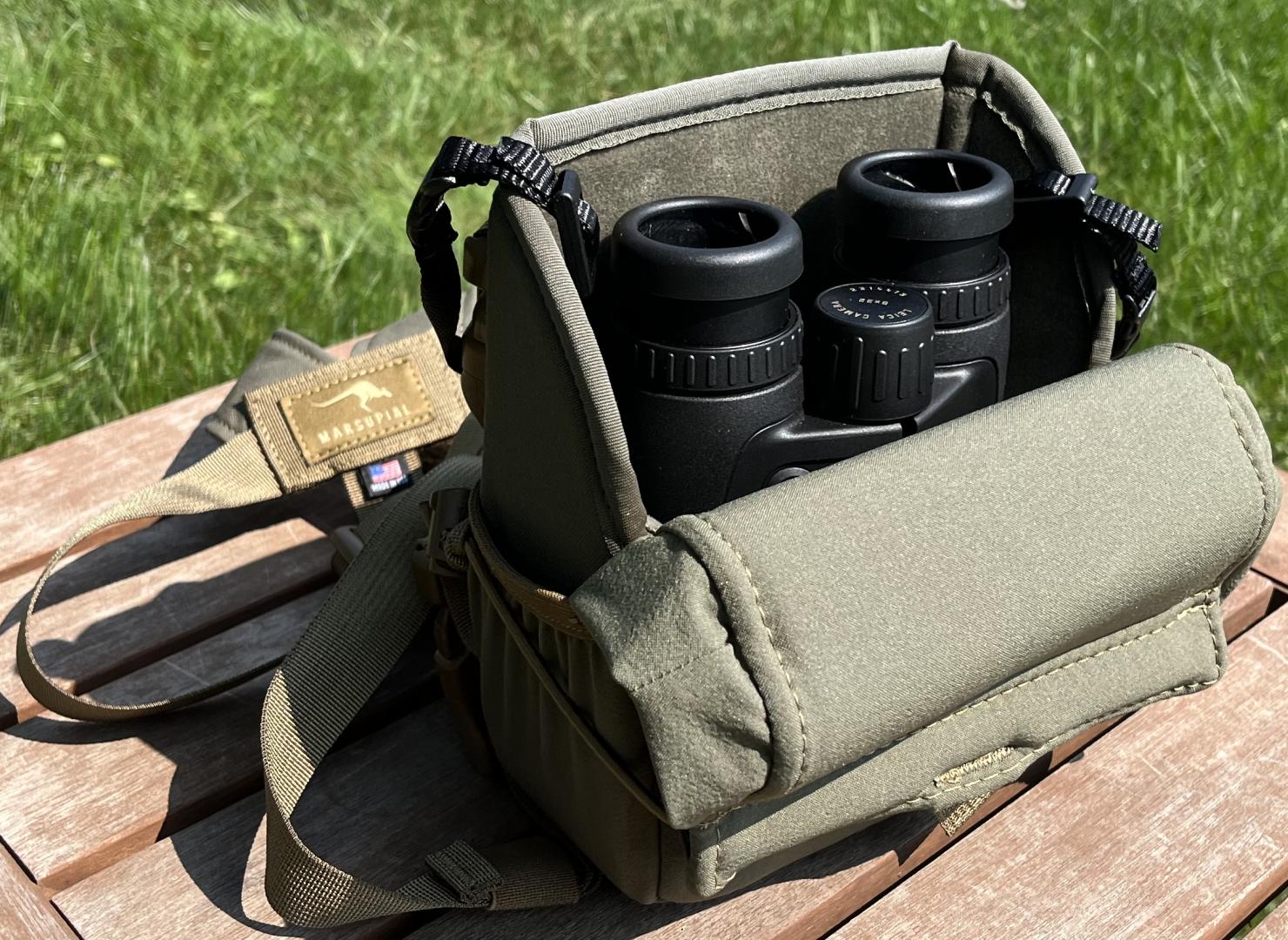

Addendum: Marsupial Gear No-Mag Enclosed Harness
Note: Since the time of this review, Marsupial gear has updated the “No-Mag enclosed binocular pack” to a new version that does not feature the bungee type enclosure. I do not recommend this new version. It’s quality of construction is still excellent but the new closure mechanism does not open as generously and grips and holds the binos with enough force when open that it is difficult to take them out or replace them. As such, I don’t recommend it.
As mentioned in this review, the case the Geovid Pro's come in is rather perfunctory. Useful to keep the binos save in storage or in transport, but not something anybody is going to use in the field. Since I bought the binos after the review, I went looking for a solution. I wanted a harness that was small enough and had detachable straps for taking the binos to the range. I also wanted one with Molle attachment points so I could add a water bottle holder for when I take the binos on a day hike with the kids and don't want to carry any other pack. Of course, I want to be able to take the binos backpacking as well, so the harness had to have straps unobtrusive enough to not interfere with the backpack straps. The case itself also needs to have enough padding and a secure enough closure that I am comfortable it will protect the binos as a storage case. Lastly, I would rather not have magnets to interfere with the already shaky digital compass.
Really, I don't ask a lot, do I? Well, after some misadventures with a couple cheap Chinese Amazon wannabees, one of which broke the first day used it, I bit the bullet and tried out a Marsupial Gear No-Mag Enclosed Binocular Pack (size small). I like it so much I decided to add this section to the review. The closure mechanism is brilliant. Easy open with one hand, a couple different open positions, and quite secure. The straps are comfortable and the harness rides nice and high. Quality of construction is downright excellent. Just so well done. The binos also fit like a golve. Couldn't be happier.
Leica Geovid Pro 8x32's in Marsupial Gear No-Mag Enclosed Pack
