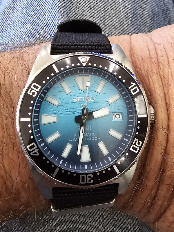

Pretty happy with my latest. 62mas conversion case, sort of a retroish thing. Top hats are cool. |

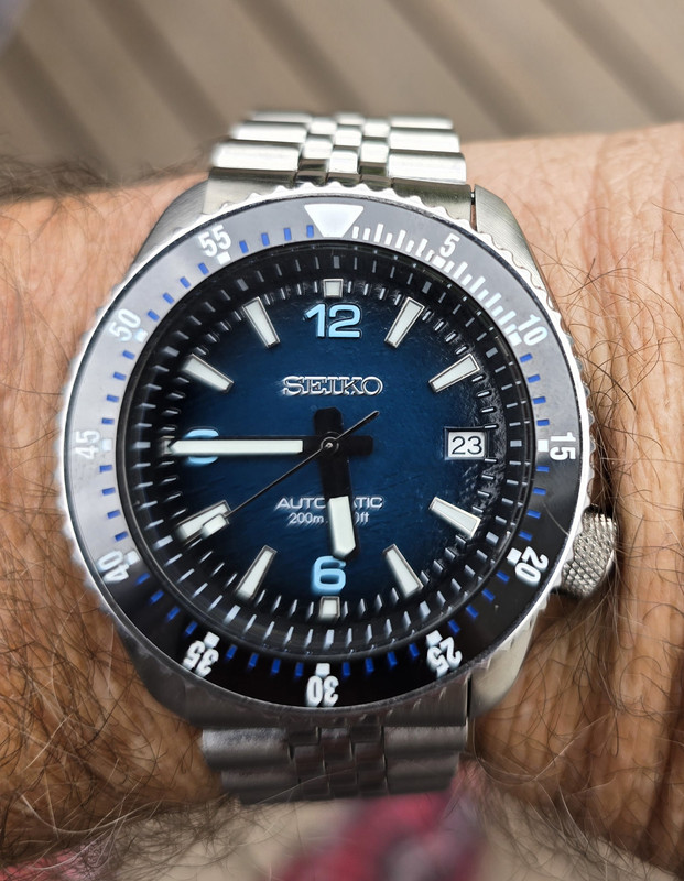

Skx style case, NH35 movement, are the majors. Dial, hands, and bracelet, just random finds I liked. I can post links later on everything except the bracelet, if you'd like. |
Originally Posted By teats: Every thing came from off AliX. Skx style case, NH35 movement, are the majors. Dial, hands, and bracelet, just random finds I liked. I can post links later on everything except the bracelet, if you'd like. View Quote Please do. I haven't started anything yet. Haven't even bought tools, so any advice on that would be appreciated. |

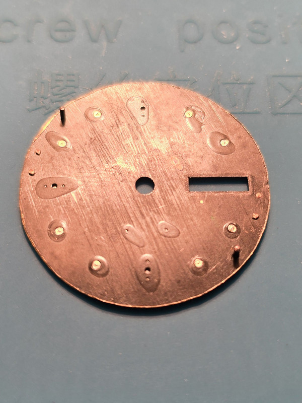

I bought a movement a dial and a case, however none of the dial legs line up with the movement. I think I need a different dial. This is what I am going for, I am so close Attached File |

Originally Posted By jsuevo: So you have all inspired me to finally get started and when I saw that parts could be sourced from Ali Express, I was not so concerned with damaging something during my learning curve. I bought a movement a dial and a case, however none of the dial legs line up with the movement. I think I need a different dial. This is what I am going for, I am so close https://www.ar15.com/media/mediaFiles/81816/IMG_0387_jpeg-3313282.JPG View Quote There's probably 4 legs on the dial. You have to trim off the 2 you don't need to get the date window lined up with the stem. |
Originally Posted By jsuevo: So you have all inspired me to finally get started and when I saw that parts could be sourced from Ali Express, I was not so concerned with damaging something during my learning curve. I bought a movement a dial and a case, however none of the dial legs line up with the movement. I think I need a different dial. This is what I am going for, I am so close https://www.ar15.com/media/mediaFiles/81816/IMG_0387_jpeg-3313282.JPG View Quote You didn't say what movement you have, but if it's an NH35, with that case you have, these are the 2 pin positions you will need to use to line up at 3 o'clock. |
Originally Posted By RolandofGilead: There's probably 4 legs on the dial. You have to trim off the 2 you don't need to get the date window lined up with the stem. View Quote View All Quotes View All Quotes Originally Posted By RolandofGilead: Originally Posted By jsuevo: So you have all inspired me to finally get started and when I saw that parts could be sourced from Ali Express, I was not so concerned with damaging something during my learning curve. I bought a movement a dial and a case, however none of the dial legs line up with the movement. I think I need a different dial. This is what I am going for, I am so close https://www.ar15.com/media/mediaFiles/81816/IMG_0387_jpeg-3313282.JPG There's probably 4 legs on the dial. You have to trim off the 2 you don't need to get the date window lined up with the stem. I just learned this on my first build. My dial came with 6, I used nh35 movement and trimmed off 4. |

Originally Posted By d16man: I just learned this on my first build. My dial came with 6, I used nh35 movement and trimmed off 4. View Quote View All Quotes View All Quotes Originally Posted By d16man: Originally Posted By RolandofGilead: Originally Posted By jsuevo: So you have all inspired me to finally get started and when I saw that parts could be sourced from Ali Express, I was not so concerned with damaging something during my learning curve. I bought a movement a dial and a case, however none of the dial legs line up with the movement. I think I need a different dial. This is what I am going for, I am so close https://www.ar15.com/media/mediaFiles/81816/IMG_0387_jpeg-3313282.JPG There's probably 4 legs on the dial. You have to trim off the 2 you don't need to get the date window lined up with the stem. I just learned this on my first build. My dial came with 6, I used nh35 movement and trimmed off 4. Right, good call- some will have 6 to start with. |
Originally Posted By teats: You didn't say what movement you have, but if it's an NH35, with that case you have, these are the 2 pin positions you will need to use to line up at 3 o'clock. View Quote Sorry It is an NH35 and my pins are not in the same position. It looks like I need to order another dial. Attached File |

Originally Posted By jsuevo: Sorry It is an NH35 and my pins are not in the same position. It looks like I need to order another dial. https://www.ar15.com/media/mediaFiles/81816/IMG_0414_jpg-3314349.JPG View Quote View All Quotes View All Quotes Originally Posted By jsuevo: Originally Posted By teats: You didn't say what movement you have, but if it's an NH35, with that case you have, these are the 2 pin positions you will need to use to line up at 3 o'clock. Sorry It is an NH35 and my pins are not in the same position. It looks like I need to order another dial. https://www.ar15.com/media/mediaFiles/81816/IMG_0414_jpg-3314349.JPG I would give a swag that the pins at 12 and 7 are for a 6309 movement, and maybe the 1 just below the window, and directly across might be for an NH series movement. Where, did you buy it from. The description will always say what movement it's for. I'm looking at making a pilot watch next. Here's an ad that says this dial is for what movements. |

Originally Posted By jsuevo: Sorry It is an NH35 and my pins are not in the same position. It looks like I need to order another dial. https://www.ar15.com/media/mediaFiles/81816/IMG_0414_jpg-3314349.JPG View Quote View All Quotes View All Quotes Originally Posted By jsuevo: Originally Posted By teats: You didn't say what movement you have, but if it's an NH35, with that case you have, these are the 2 pin positions you will need to use to line up at 3 o'clock. Sorry It is an NH35 and my pins are not in the same position. It looks like I need to order another dial. https://www.ar15.com/media/mediaFiles/81816/IMG_0414_jpg-3314349.JPG 2 options: New dial (that one is for a different movement) Cut all the feet off and use dial stickers instead |

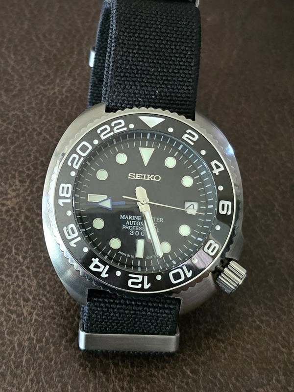

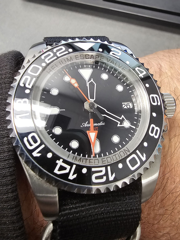

Originally Posted By teats: I present to you all, a gmt turtle ! https://i.postimg.cc/QMBJBspk/20240904-172616.jpg View Quote I like it. I'm planning my next build now. Waiting on a sale unless I can find things with coin discounts. |
Proud member of Team Ranstad. Arfcom St Jude Mafia 3 years Arfcom callsign: trenchfoot |
Originally Posted By d16man: I like it. I'm planning my next build now. Waiting on a sale unless I can find things with coin discounts. View Quote View All Quotes View All Quotes Originally Posted By d16man: Originally Posted By teats: I present to you all, a gmt turtle ! https://i.postimg.cc/QMBJBspk/20240904-172616.jpg I like it. I'm planning my next build now. Waiting on a sale unless I can find things with coin discounts. I've been buying a few small items, but waiting on a sale. I need movements, and not wanting to spend what they want at regular prices. |
