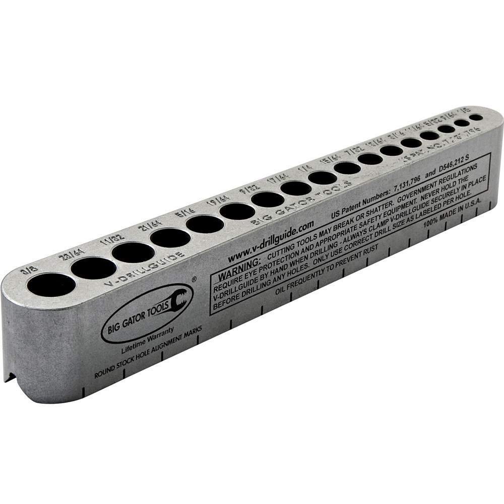

No idea if this is any good...but you could get something like this to attach to your handheld drill
Originally Posted By K1rodeoboater:
No idea if this is any good...but you could get something like this to attach to your handheld drill http://www.harborfreight.com/angle-drill-guide-95622.html View Quote That's cool. Never seen one of those. |
Originally Posted By ModulusArms: That's cool. Never seen one of those. View Quote View All Quotes View All Quotes Originally Posted By ModulusArms: Originally Posted By K1rodeoboater: No idea if this is any good...but you could get something like this to attach to your handheld drill http://www.harborfreight.com/angle-drill-guide-95622.html That's cool. Never seen one of those. They were a lot more prevalent back in the 50's and 60's, sometimes sold with the corded drills, and only for 90 degrees (not adjustable for 45's or anything). They sort of disappeared after that point. They're not super accurate but they're better than doing it free-hand so long as the locking mechanism doesn't slip. Alternatively if you place a 90 degree square on your object you're drilling you'll find it's a LOT easier to get a 90 degree hole. |
No idea if this is any good...but you could get something like this to attach to your handheld drill http://www.harborfreight.com/angle-drill-guide-95622.html View Quote Now that looks handy as hell! Even though I have a drill press, sometimes I need to drill stuff that I can't easily move to the drill press... |

Originally Posted By SoftwareJanitor:
Now that looks handy as hell! Even though I have a drill press, sometimes I need to drill stuff that I can't easily move to the drill press... View Quote View All Quotes View All Quotes Originally Posted By SoftwareJanitor:
No idea if this is any good...but you could get something like this to attach to your handheld drill http://www.harborfreight.com/angle-drill-guide-95622.html Now that looks handy as hell! Even though I have a drill press, sometimes I need to drill stuff that I can't easily move to the drill press... I went to Harbor Freight but both of them in town were sold out... I did however find this. I had to order it because it isn't something they stock in the store... but it looks good. Probably more expensive than the Harbor Freight one, but available... http://www.homedepot.com/p/General-Tools-Drill-Guide-and-Chuck-36-37/100349264 |
Probably way better quality to be honest.

They were a lot more prevalent back in the 50's and 60's, sometimes sold with the corded drills, and only for 90 degrees (not adjustable for 45's or anything). They sort of disappeared after that point. They're not super accurate but they're better than doing it free-hand so long as the locking mechanism doesn't slip. Alternatively if you place a 90 degree square on your object you're drilling you'll find it's a LOT easier to get a 90 degree hole. View Quote View All Quotes View All Quotes Originally Posted By K1rodeoboater:
No idea if this is any good...but you could get something like this to attach to your handheld drill http://www.harborfreight.com/angle-drill-guide-95622.html That's cool. Never seen one of those. They were a lot more prevalent back in the 50's and 60's, sometimes sold with the corded drills, and only for 90 degrees (not adjustable for 45's or anything). They sort of disappeared after that point. They're not super accurate but they're better than doing it free-hand so long as the locking mechanism doesn't slip. Alternatively if you place a 90 degree square on your object you're drilling you'll find it's a LOT easier to get a 90 degree hole. Those Harbor Freight and similar angle drill guides have pretty awful customer reviews. I thought something similar for 90 degree holes (namely for the trigger holes) would be pretty smart. This seems to be the ticket - $21.47 shipped via Amazon Prime ![]() |
NRA Life Member
Originally Posted By troy_v:
Those Harbor Freight and similar angle drill guides have pretty awful customer reviews. I thought something similar for 90 degree holes (namely for the trigger holes) would be pretty smart. This seems to be the ticket - $21.47 shipped via Amazon Prime http://ecx.images-amazon.com/images/I/612o%2Br4lGgL._SL1000_.jpg View Quote View All Quotes View All Quotes Originally Posted By troy_v:
