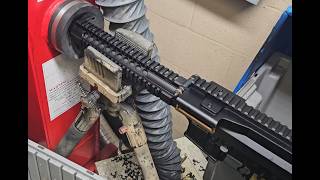

Here's what I cooked up today. Lima-Lewis.
Had to turn down the barrel for a JP heat sink, its not ideal but for proof of concept.
Then I made a 22" aluminum shroud thats keyed to the RPD rail and is slotted where the gas tube enters the receiver as well as bored with a 3 degree taper.  Also cut the gas tube mount off of a vz26 bipod and turned a new ring to mount it on the shroud.
Gonna run home for ammo and the m145 and see if I can determine whether this was worth the effort at the range
Flipping sweet!!  Longtime Bump-Saw thread people will know my preference for the Bump-Lewis which became the FRT-Lewis.  And I want the same 20" barrel with 19" handguard for the Lima Six.  (But really it is a little weird since the Lewis didn't have a belt).
I would like to remind everyone that disorganized violence is never the answer. - John Carter
8/8/2026 11:35:58 PM EDT
I need to think some more about how to test the efficacy of this setup but my first impression with an IR thermometer is that it's definitely helping.  Having some reliability issues as I break it in so no 100 round strings but definitely got through some 30-50 round strings and the barrel nut, heat sink both only got up to 200 degrees.
I should have brought one of my thermals.  And having the bipod way out there really does make for a well supported firing position. 4-5 round hits at 200 yards on a "D" plate was no problem.
https://www.ar15.com/media/mediaFiles/125898/4899-3808004.jpg
https://www.ar15.com/media/mediaFiles/125898/4900-3808005.jpg
https://www.ar15.com/media/mediaFiles/125898/4901-3808007.jpg
https://www.ar15.com/media/mediaFiles/125898/4903-3808009.jpg
That is dope.
I’m interested in seeing how much of a vacuum is put on the rear of the tube.
Be neat to do a 30rd belt with a smoke machine at the rear to see how much it actually sucks and pulls across the fins.
8/9/2026 8:10:03 PM EDT
Yes I've planned to do this but not sure if I'm going to use it as an excuse to buy a smoke machine or just try some smoke bombs.
Going to try one of these cheap things.  Supposedly has 10 seconds of charge which should be plenty if the air is relatively still.

8/10/2026 9:46:09 PM EDT
Happy day, the mail man came. Prebuild mock up, this thing is going to look awesome.
I wanted to get barrel in tonight, but notice. RRH specifically calls out for the but to not bottom out against the receiver, so I was checking things with feeler gauges just make sure. Unfortunately, it works without shims but the cutout in the nut for the gas tube won’t quite line up. Hand tight without shims it’s perfect, but I’d either need a more shims (maybe .010”-.020” worth with a bad guess) to need to give it 35-40 ft/lbs or I’d need to crank it down with a lot of torque to get essentially a quarter turn of the barrel nut. I did use feeler gauges and there’s still no contact with the nut, about .010” of space between the gas tube and the nut.
I already had difficulty with the barrel nut wrench not fitting real well in the cutouts, so I’ll reassess in the morning. It already slipped out once, looked like only about 1.5 of the teeth were engaging, so I need to look at the wrench and see what’s intefering with the nut.

8/11/2026 4:46:28 PM EDT
[Last Edit: Kuraki][Edited] [#40]
https://www.ar15.com/media/mediaFiles/226396/IMG_0174-3809471.jpg
Sometimes I'll grease it up good, crank it to 35lb, crack it loose, and repeat 3-4x without shims then re-evaluate as the threads stretch a bit.
