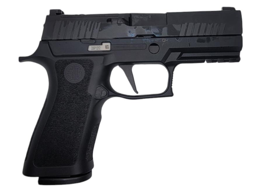

ICE renewed their contract with SIG and the P320 last week.  The whole ICE thing was fake hype shit, wonder how much of this actually is?
If you follow the link to the approved gun in that story, the gun is covered in blue goo.  Even if they are shipped to distributors like that, you'd think they'd clean it off for the photo.  Also that story doesn't say how old it is, but the copyright shows 2009-2021, so that might be 4 years old.
