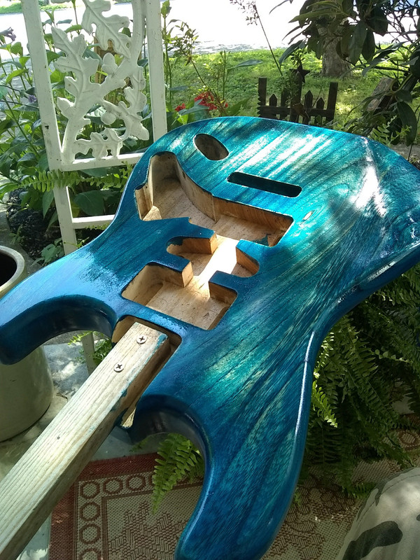

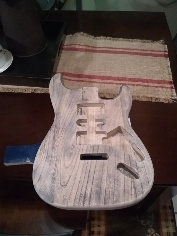

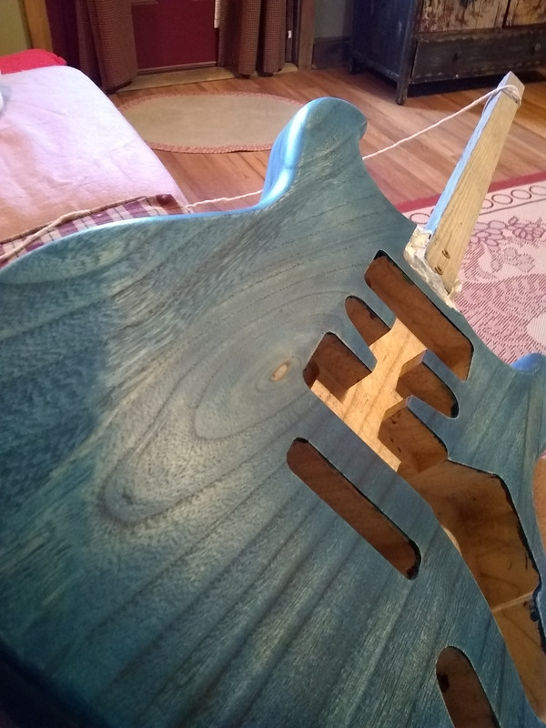

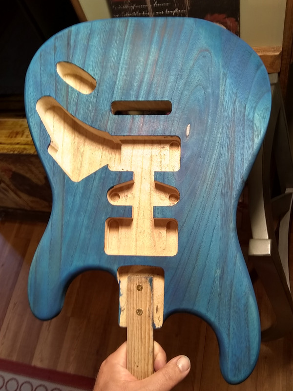

I want to make a somewhat authentic 70's Strat, but part of me wants to do this as well:
I know that would be MUCH easier than painting. Sand down to 800-1000, apply dye with a cloth, then 8-10 coats of spray poly, wet-sanded and polished, and you're there. I've refinished enough rifle stocks to be able to do that in my sleep...lol.
So, if the paint ends up a sloppy mess, the whole thing gets stripped, sanded, dyed, and poly'd. This is plan B.

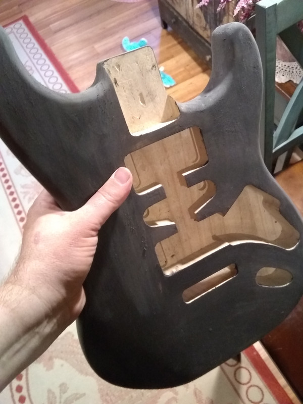

Edit again:  Not great pictures, but here is a before and after shot.
27 years of built up grunge.

So, I made grain filler out of wood filler and black paint, diluted it with a little water to make a thin paste, then filled the entire body of the guitar...
Then, sanded back to wood:
Then, hit it with the blue dye:
Distressed the grain a bit by sanding:
And now, layering on the Tru Oil...
Added bonus...the Tru Oil is a bit yellow, so it's slowly turning the color turquoise.
I'm OK with that...lol.

The movement of the grain on the body looks really good with the color choice.
7/19/2020 7:17:40 PM EDT
Yeah, it's crazy everything that's going on in that grain. I'm glad I filled it before I started or it wouldn't have been nearly as interesting.
