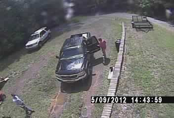

OH GREAT GRAYMAN… I’m not worthily
So,  here’s my setup.. If you don’t mind, could you tell me when I need an IR flood light?

My latest install.
I really love this camera.
Here is someone walking up to the garage door.
A different angle: (and a cheaper camera)

My newest addition:
This is my first IP only camera. I have another analog/IP camera and 4 analog cameras.
I'm going to build a server this weekend if I have time to run the two IP cameras until I can fully migrate over.
