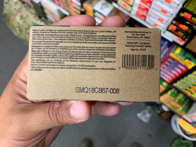

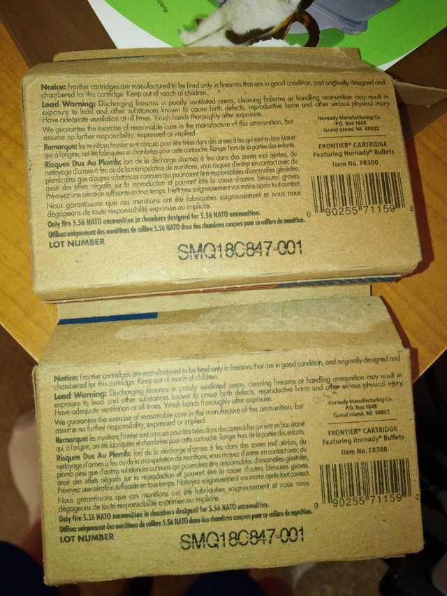

https://i.ibb.co/cxh66kc/D0LNWY.png https://i.ibb.co/Wp9Lt7M/rs8rm-Im-d.jpg https://i.ibb.co/3TbCsWh/20180909-215113-666931.jpg The other two pics I posted are other Hornady Frontier Lots associated with kabooms. As you can see, they are all close together in lot numbers. oh the noes |
As you can see, they are all close together in lot numbers. SMQ18C8 Below are all of the known lot numbers I found associated with kabooms SMQ18C844-002 SMQ18C844-003 SMQ18C847-001 SMQ18C867-008 ( from this thread) |
Quoted: yep the lot number kept getting higher, Im sure the rest of them are GTG oh the noes The only facts we have are the close together lot numbers associated with the kabooms. Again, SMQ18C8 seems to be the common denominator. |
Quoted: That's the way I see it. There is no evidence to indicate otherwise. It's just speculation. The only facts we have are the close together lot numbers associated with the kabooms. Again, SMQ18C8 seems to be the common denominator. |
