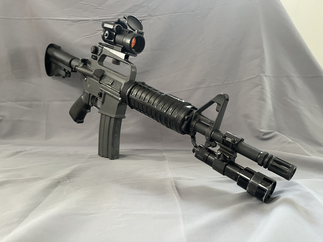

Got it mostly completed, not 100% clone correct but enough for my purposes. Last thing I’ll probably do is grab a more clone correct muzzle device. Rocking the vector x1 prism in it now just cause I got a smoking deal on it and wanted to try it out.
Need to get some range time with it.
It’s mostly PSA, but had parts from B5, BCM, Midwest industries, and streamlight mixed in.

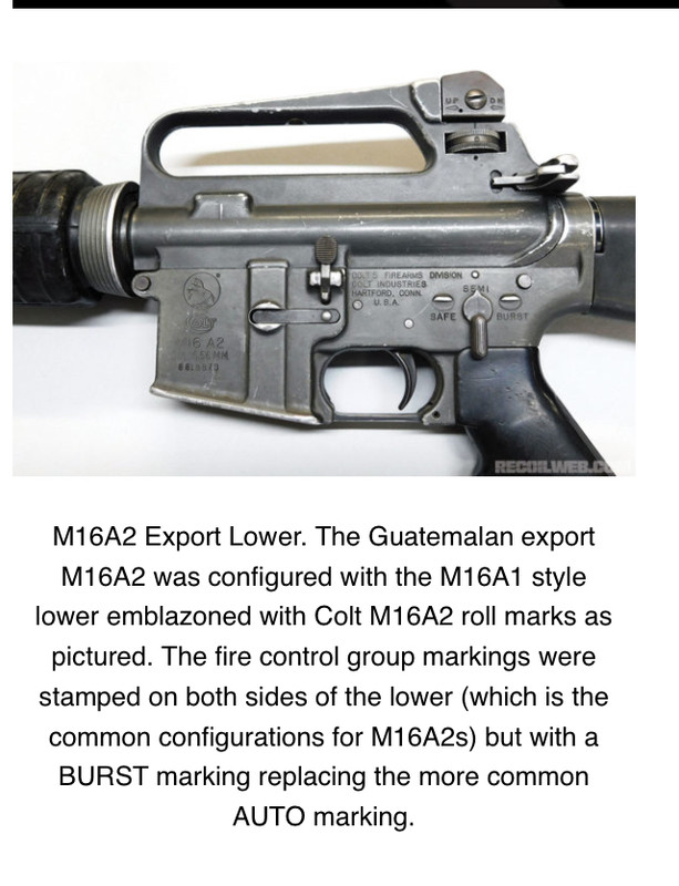

So what is correct? An A1 or A2 pistol grip?
6/15/2025 2:58:20 PM EDT
The movie rifle had an A2 grip.
6/18/2025 12:54:28 PM EDT
Originally Posted By Sputnik556:
I keep these pics handy because most people don't even know there's a difference.
https://i.imgur.com/7uosYBh.jpeg
https://i.imgur.com/p9ZWNOB.jpeg
https://i.imgur.com/wHRMGr8.jpeg
Anyone have a source for the old style pistol grips?

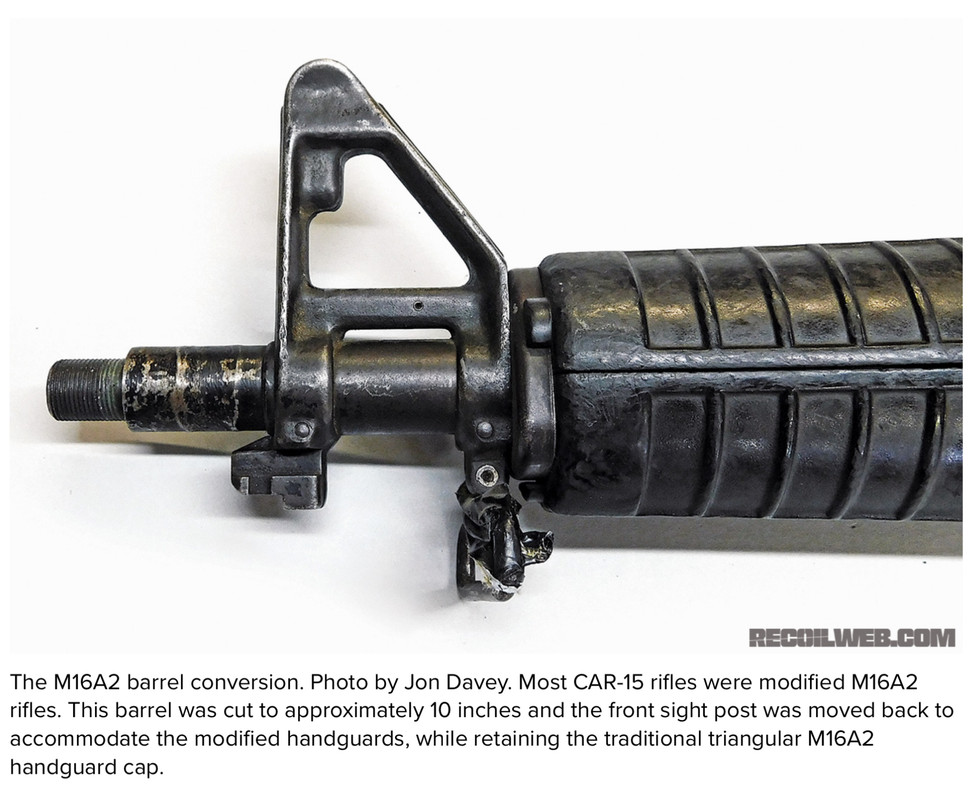

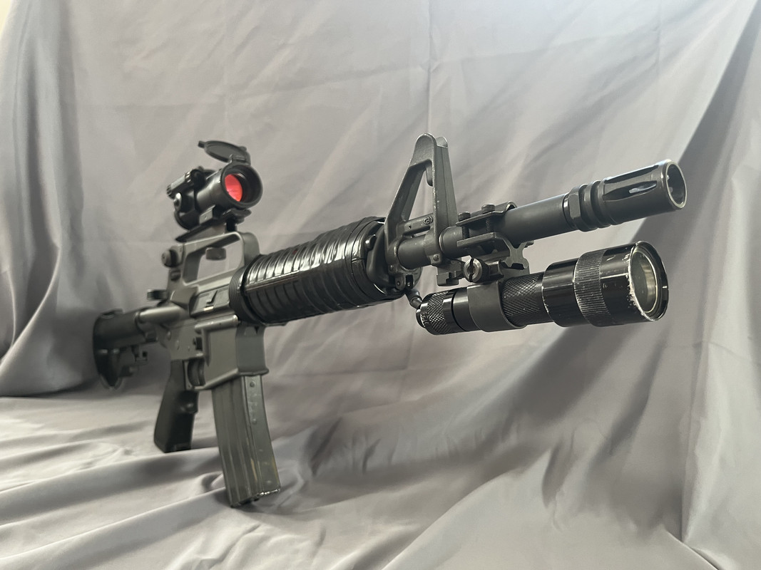

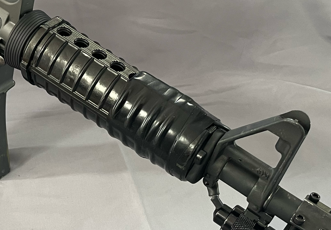

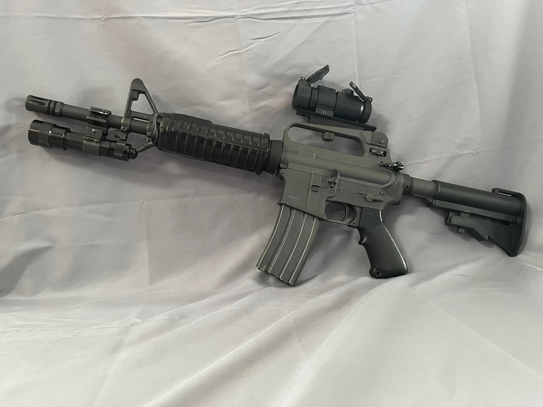

This isn't a Blood Diamond clone, it's actually a Black Hawk Down Sanderson Movie Clone but it has 80% of the same parts the BD Rifle had (not the muzzle device or placement of the weapon light), so I figured you guys might appreciate it.
This was a really fun build. I sent the barrel off to Retro Arms Works to chop the barrel and install the triangle front cap.
I found a source for $5 shiny M16A2 handguards and bought a couple of sets to experiment on chopping them up.
Once I got the dimensions right, I used a hot glue gun with a black glue stick to cement the chopped parts together.
The B Square mount, Aimpoint wide ring and Aimpoint Comp M with the correct lens cap took some digging to source and put together, as did the commercial spec CAR Stock.
The light is a genuine Surefire 660 with a genuine Surefire M14 Barrel mount and pressure switch.
I'm hoping to get to the range soon to zero it.

Well done! That looks great. I haven’t added the moderator to my Heat build turned Blood Diamond build with the addition of the red dot and spray paint, haha.
7/20/2025 9:33:26 PM EDT

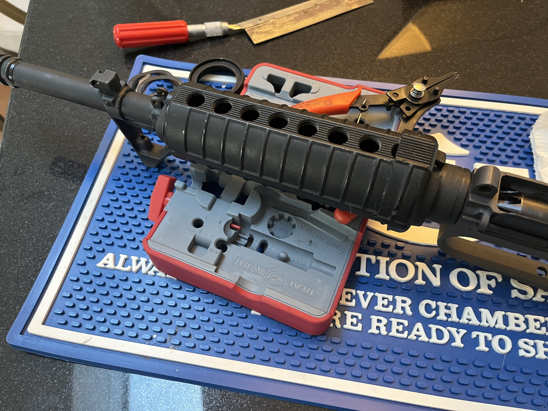

[Last Edit: CapnMike][Edited] [#14]

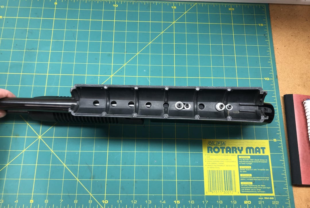

Thanks Fellas
The Hand guard chop was pretty easy.
I removed the Delta ring from the barrel, then attached the barrel and barrel nut to the receiver.
This allowed me to use the barrel, triangular cap and barrel nut as a jig to size the handguard properly. This is an old banged up handguard I started experimenting with.
I found a dremel with a cutting disc was best for the chop, then I used a solid sanding block to make both halves mate up properly.
I used silicon repair tape to hold the tape switch on. The Handguard is solid and doesn't need the tape to hold it together.
7/20/2025 9:39:48 PM EDT

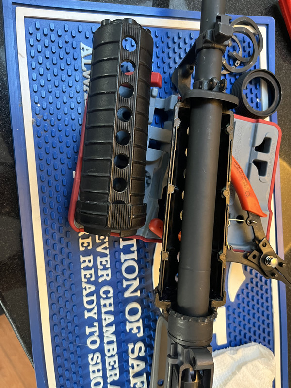

Originally Posted By CapnMike:
Thanks Fellas
https://i.postimg.cc/q7wcngBm/IMG-2819.jpg
I removed the Delta ring from the barrel, then attached the barrel and barrel net to the receiver.
https://i.postimg.cc/tgptYFbZ/IMG-2818.jpg
Smart!
I had been putting this off but now you have given me inspiration doing it a way I never thought about.

[Last Edit: reccerecon][Edited] [#17]
Thanks Fellas
https://i.postimg.cc/MTryP4QV/IMG-0553.png
Damn man, that’s a really smart way to do this. When I did mine I just laid a CAR handguard on a 2x4 and screwed on a couple of short blocks on each end for my jig. I used JB Weld to attach the two pieces and they came out great, it was a process getting the two pieces sanded to fit together correctly. I got to say that I love movie gun clones and this is one that isn’t ever seen, great job.
ETA. The cut down heat shields can still be used in these handguards with a little modification, if you have them.
7/21/2025 11:10:37 AM EDT
[Last Edit: CapnMike][Edited] [#18]
You do have to sand on the front piece a bunch to get the rear piece to fit on top of it.
I had forgotten that.
Imarked the front piece with a razor saw, then used the dremel to get every thing flat till it fit. Took some off the underside of the rear pieces also.
Good to know about the heat shields.

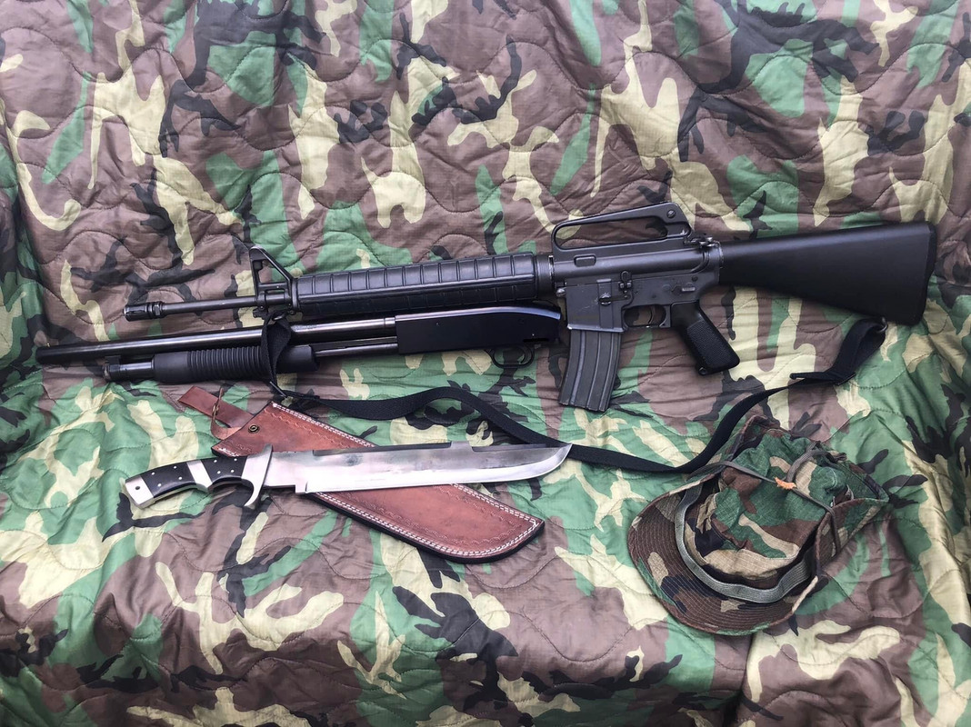

I'm waiting on an A2 upper. In the meantime I'm playing around with stuff. Here's my original Aimpoint Mark III on one of my 10.5" uppers.

8/5/2025 4:58:15 PM EDT
I tried one.
It's a Certo Forge upper. Colt gray. Six hole hand guards. The muzzle device is rather large and slotted all the way around. It had a scratch on the bottom.
It would not take any of my GI charging handles. The upper was too tight. I'm guessing it was not finished properly or is out of spec.
The rear sight had been assembled incorrectly. I was able to fix that. The front sight base is canted to the right.
Waiting to see what they'll do with it.

8/13/2025 7:52:01 PM EDT
https://i.postimg.cc/fbzmwZ7Y/IMG-2976.jpg
https://i.postimg.cc/RZQD0c8y/IMG-0474.jpg
https://i.postimg.cc/2SFnR3Wz/IMG-2985.jpg
https://i.postimg.cc/7YRQkp1s/IMG-0280.jpg
https://i.postimg.cc/g2vHzNCb/IMG-0279.jpg
https://i.postimg.cc/05FY7Txq/IMG-2979.jpg
https://i.postimg.cc/sfq8Hf76/IMG-0165.jpg
Is that an original LSO grip or one of the newer versions?

8/14/2025 11:59:57 PM EDT
It's an original.
not correct on that build, but I swap that SBR lower between a few builds.

8/15/2025 1:34:33 PM EDT
I tried one.
https://www.ar15.com/media/mediaFiles/668/IMG_4520-3600989.jpg
https://www.ar15.com/media/mediaFiles/668/IMG_4521-3600990.jpg
https://www.ar15.com/media/mediaFiles/668/IMG_4524-3600988.jpg
https://www.ar15.com/media/mediaFiles/668/IMG_4525-3600986.jpg
They just sent me a replacement upper. No notes or comments about the first one. This one looks good so far.
When I get time I have a triangular hand guard cap I can install. If I do that I may install a slip ring in place of the delta ring. Not sure if it's worth it or not.
I have the PSA / HR muzzle device that will go on. It just looks better.
I need a different ring for the Comp M. The one I have is too low and won't clear the lense caps.
