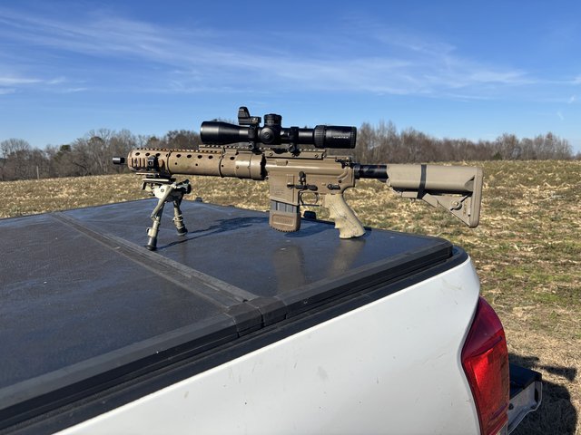

12/8/2024 6:32:54 PM EDT
[Last Edit: bzugger][Edited] [#22]
Took my 6arc MR to a PR class yesterday. I was the only Gas gun there and everyone else had a 6.5 creedmore.i have a mk5 3-18 and the glass clarity really matters at extended ranges. Shooting 108 eldms @2450. Did a couple 3 round groups to check my zero. According to my public school math this is .507 in.
Was able to hit steel at 907 4 out of 5 times.dope was 33 moa with about 310 inches of drop. 0 value on wind and about 60 degrees. Audio feedback on the steel was non existent beyond 700.
Rifle is a 6arc with a bunch of noveske parts.14.5 barrel, upper, lower rail. Jp bolt. Geissele g2s trigger. Mk5 3-18 in a badger mount. Shooting with a bipod and rear bag mostly. I couldn't hang with the 6.5s. But a couple guys got out their 5.56 guns with lpvos and were hitting 1 for 5 at 500. I'd say that the 6mm round is no substitute for the heavier calibers. But is a lot lighter that the larger calibers.

@135Patriots what safety are you running?
1/2/2025 8:15:57 PM EDT
Looks like the FCD short throw with the a levers
1/2/2025 8:39:57 PM EDT
