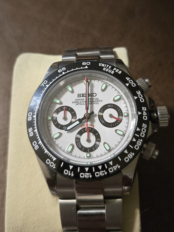

Originally Posted By teats: I've been checking the hours against the right dial. Its divided by 1/3's. At 08:00, the right dial is at 10. Twist again another 8 hours to 4 pm, and its at 20. Some kinda odd time keeping. https://i.postimg.cc/T1wYM8mC/20251014-183739.jpg I'm guessing that watch needs a movement that has a 30 minute feature in that dial. |

Originally Posted By ColdboreDreamer: Sounds like it's a VK63 movement as that would be the correct hand position for the 24 tracking, no? I'm guessing that watch needs a movement that has a 30 minute feature in that dial. Originally Posted By ColdboreDreamer: Originally Posted By teats: I've been checking the hours against the right dial. Its divided by 1/3's. At 08:00, the right dial is at 10. Twist again another 8 hours to 4 pm, and its at 20. Some kinda odd time keeping. https://i.postimg.cc/T1wYM8mC/20251014-183739.jpg I'm guessing that watch needs a movement that has a 30 minute feature in that dial. Yeah, its a VK63 movement. I have 4 I've assembled. I ordered a diver style case for a VK63. I think I'm going to move my white Panda specimen into it, with a blue lumed, black bezel insert. |

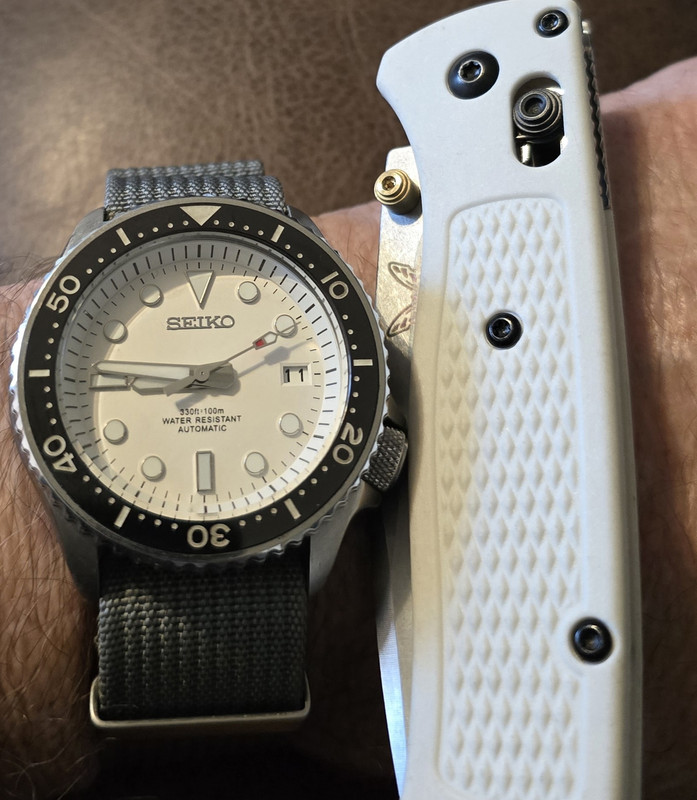

Changed the second hand in this one. May go back to white but wanted something a little different. This was the 1st one I built.

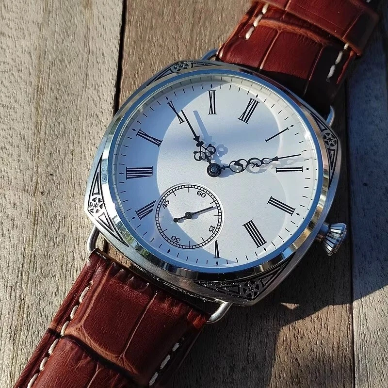

I built this for my mom for Christmas Attached File |
Originally Posted By RolandofGilead: I built this for my mom for Christmas https://www.ar15.com/media/mediaFiles/45602/1000019721_jpg-3703831.JPG |

Originally Posted By RolandofGilead: I built this for my mom for Christmas https://www.ar15.com/media/mediaFiles/45602/1000019721_jpg-3703831.JPG That is awesome. details? |

Thanks guys! It's a Meridiano case which is the smallest available for an NH movement. The dial is from dial maker, and the hands are AliExpress specials which I've actually had good luck with and I've really not noticed a difference between these and $25 hands. |

The Seiko NH05 Date only and NH06 Day and Date are great sizes for women's watches. Seagull ST6 is another one that is popular.![]() Building a Teeny-Tiny Datejust For A Very Special Somebody |

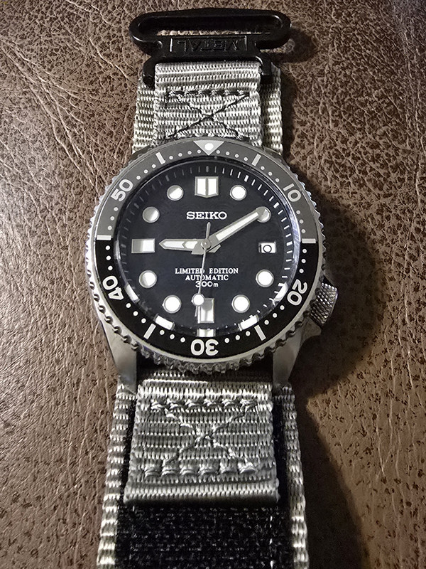

I just finished putting together my first homemade watch. It’s sort of a pilot/dive/GMT hybrid in a titanium Pelagos FXD knockoff case with fixed bars. Attached File |
