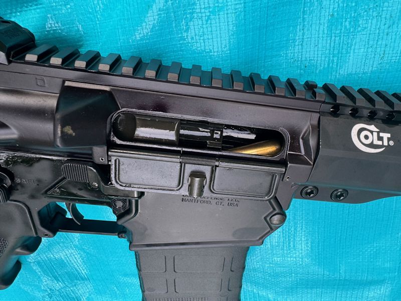

I was able to put 120rds through mine tonight.  The results were not good.  I used the Magpul magazine that came with the rifle for all shooting.  All of the ammunition used is 7.62x51, not 308Win.  The bolt locked back after each magazine was emptied.
1x20rds IMI 150gr FMJ: The first two cartridges fired, but the 3rd short stroked failing to feed the cartridge at all.  From there, it was shoot two and then the 3rd cartridge would fail to feed at all.  All failures to feed were from the right side of the magazine.  Then the remaining few all fed and fired without issue.
1x20rds Federal XM80C 149gr FMJ: After chambering the first cartridge, the next seven failed to feed at all, the next partially fed up the feed ramp, the next two cycled fine, then next partially fed up the feed ramp and then the rest all fed and cycled just fine.
1x20rds Saltech 150gr FMJ: All fed and fired 100%.
1x20rds IMI 150gr FMJ: All fed and fired 100%.  At this point I was hoping that perhaps the rifle had sorted out whatever went wrong, but it wasn't to be.
1x20rds GGG M80 147gr FMJ: The 3rd cartridge failed to feed at all, then there were three partial feeds up the feed ramp and then the rest all fed just fine.
1x20rds Federal XM80C 149gr FMJ: The 3rd and 4th cartridges failed to feed at all.  The rest fed and fired fine.
The spent case ejection was about 8' on average with the Saltech going perhaps a couple of feet more.  The significant majority of misfeeds were from the right side of the magazine.  Furthermore, virtually all of the misfeeds occurred when the magazine was over half full.  I could literally feel when the rifle misfed and when it cycled correctly.  Based on my experience with other rifles, the rifle is behaving like it is under gassed, over sprung or has too heavy a buffer weight.  However, based on most of the misfeeds occurring from the right side of the magazine when it was over half full, I believe that the cartridges in the magazine are creating resistance on the underside of the bolt when it's cycling rearward.  Again, the bolt locked back after each magazine was emptied.  This typically indicates that it's getting enough gas.  I have some D&H SR25 pattern magazines, so I can get them a try to see if they make a difference.  BTW, I have a LE901-16SE that's been 100% reliable from the start.
I didn't take any pictures showing when the rifle completely failed to feed because that just looks like the rifle with the bolt closed.  Here's a picture that I took of a typical misfeed up the feed ramp.
On the plus side, I really like the feel of the rifle.  The way the buttstock lines up with my cheek is nice.  I think that I'll really like the 13" M7 that I ordered, assuming I can get it running reliably.
All of the news wasn't bad.  My Taurus 917 C (Beretta 92 clone) functioned 100%. :)
https://i.postimg.cc/MZPKGJ8M/M7-misfeed-typical-on-1st-day-of-shooting.jpg

Originally Posted By MiamiSniper:for everything you've mentioned it sounds like the magazine was the problem, what other magazines fit this weapon? Armalite AR10 mags? did you clean and lubed the weapon before shooting?
Yes, I gave the rifle an initial cleaning and lubed it up.  It was pretty dry, but not dirty.  You can see in the picture that the bolt is wet.
At this point I suspect that it's the magazine being too high in the magazine well or under gassing.  SR25 pattern magazines (not original Armalite M14 conversion type) fit this rifle.  I'll try a D&H metal magazine next.  I also have some Sentry Hexmags that fit.  I can also shoot the same ammunition using the Magpul magazine that came with this rifle in my Colt LE901-16SE.
This is interesting because the original 901 mags from Magpul, as you may well know, had a tab on the back to prevent over insertion. Does the mag from your 901SE have that tab?

I'll double check when I get home, but it appeared to be the same as any other Magpul magazine when I took it out of the package.  Upward pressure from a cartridge slowing the bolt carrier as it travels rearward is pretty typical in a magazine fed semiauto.  For example, when I did a mag dump using my Sig 516 upper half on my M16 lower, I noticed that the cyclic rate increased as the magazine was emptied.  As each cartridge was shot, there was less upward pressure put on the bolt carrier as it traveled rearward.  Less upward pressure means a faster cycle.  The question here is if there's too much upward pressure or not enough gas or something else.
6/5/2024 2:08:15 PM EDT
can you hand cycle the whole mag manually?

Malfunction Update for the Colt CM762
Today I went out to check function on my CM762 in the AZ desert heat at 3:00 pm.  I only shot 6o rounds of three different types of ammo.  I began with PMC Bronze 308 Win 147 Grain FMJ-BT then switched to Sellier & Bellot 308 Win 147 Grain FMJ and final 20 rounds of MEN 7.62x51 147 Grain FMJ.  I used a 25 round Gen M3 PMAG and shot from standing and prone using the magazine as a monopod out to 100 yards.  PMC all rounds functioned in my Colt with no issues.  Ammo fed using charging handle or using the bolt release.  The BCG did lock back on the last round.  I then shot the S&B  and had one malfunction as I was shooting in the prone.  The round failed to feed and was in a upward position.  I removed the magazine and the round fell out with no issue.  I examined the round and there was a dent in the casing near the neck and the bullet appeared to be slightly crooked.  I pulled on the bullet to see if it was loose but it was still tight and locked in.  The malfunction happened midway of the 20 rounds.  I shot the last 20 rounds of the MEN ammo 7.62x51 and had no issues, loading, feeding, chambering and locked back on last round.
I felt the rifle shot smoother this second time and did not feel as tight in function.  I had previously posted my 4 to 5 malfunctions issues ranging from failure to chamber, failure to lock back on last round and failure to strip round from magazine.  I feel a little better but the round count is still minimal.  When you pay 2200.00 its a little concerning but with any firearm you need good magazines and ammo.  I will post a picture of the malfunctioned round.
(Noticed after the third cleaning that pulling on the charging handle is much easier and the BCG feels much smoother.)
Rough day at the range when a Taurus functions and a Colt does not.
